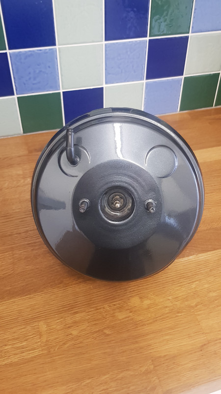

So on with fitting things, got the brake booster in with new gaskets and formed vac hose I have had waiting in my box of new oem stuff for ever, brake master cylinder with new throttle cable bracket. Also picked up 2 litres of Motul 660 fluid which is very pricey but supposed to be the best.

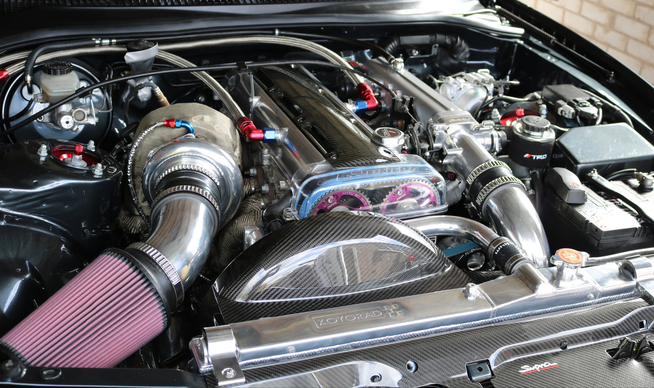

Last month I used my time during the lockdown to crack on with the engine bay. My goal was to start finishing a lot of the systems as I am getting closer to completion.
First up was the cooling system. I ran in to an issue where the lower water neck and boost pipe were too close, so I ordered an adapter plate to rotate the water neck 90 degree. It did the trick but was a pain to fit!
I received a nice delivery which included a Koyo radiator, HKS cap, Whifbitz carbon shroud and polished upper pipe. The Koyo rad is excellent quality, although expensive. The mounting tabs on the carbon shroud were out by a fair way so I had to open them up with the dremmel to get a good fit.
I applied some foam tape between the rad and shroud to fill the gaps and maximise airflow.

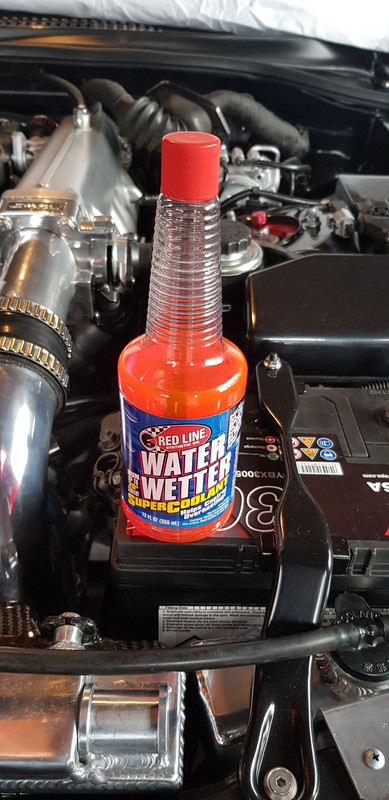

After fitting the rad and shroud along with the new upper pipe I fitted a new oem lower hose, which I cropped to work with the turned lower neck. I filled the system with Toyota red coolant and added some water wetter, which probably will make no difference, but thought I would give it a try. I filled the block through the upper pipe (turned up the way like a spout) so there is less bleeding to do when the engine runs.
The only thing is didn't account for is with everything being bigger the boost pipe sits very close to the shroud, it's snug, but ok...just!
With the coolant system filled and no leaks it was to the boost pipework. I bought a mounting bracket for the boost solenoid from SRD which did the job nicely! I soldered plugs to the solenoid and the old wires for the stock wastegate vsv, which i will assign to the link to keep the wiring neat. I also got my Turbosmart bov welded to the boost pipe on the intercooler outlet and Murray clamps fitted to the joiners.
With the cooling and boost sorted next up was the power steering. I ordered a mocal 13 row cooler kit from SRD, and made mounting brackets from alloy angle. I am really pleased with how it is fitted, hopefully will get plenty of air fed through the opening in the front bumper. System was filled with Motul dexiii.
