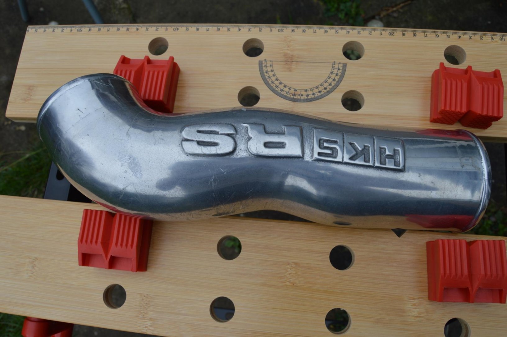

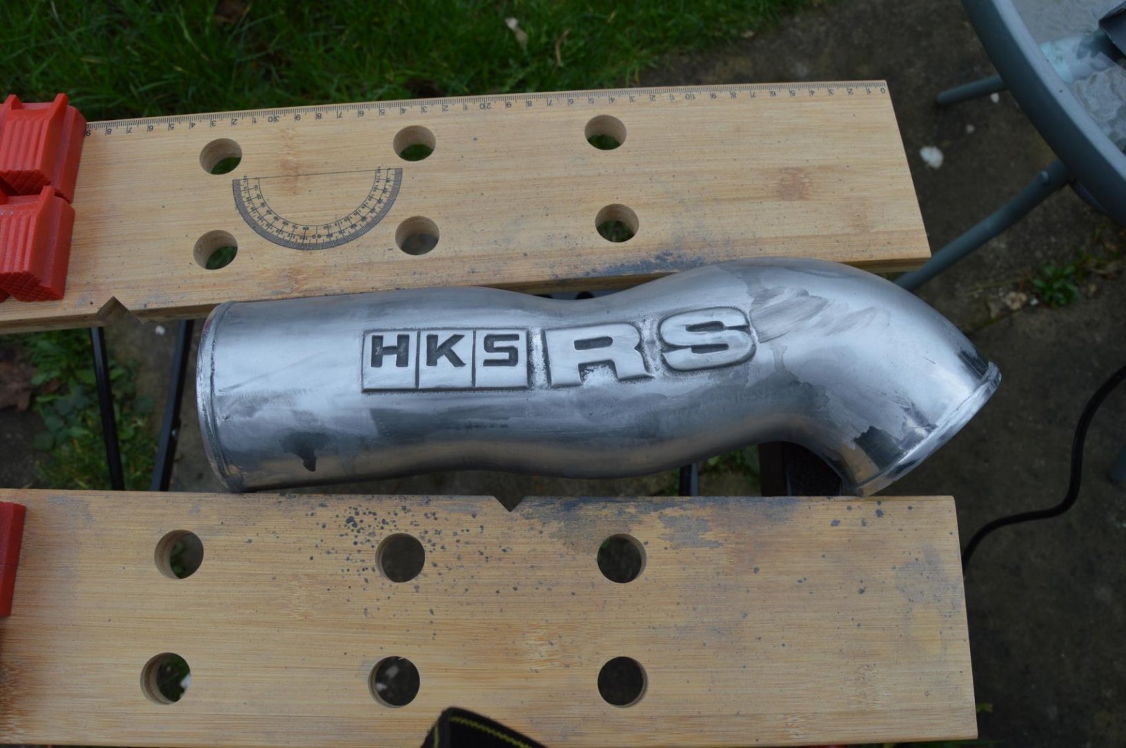

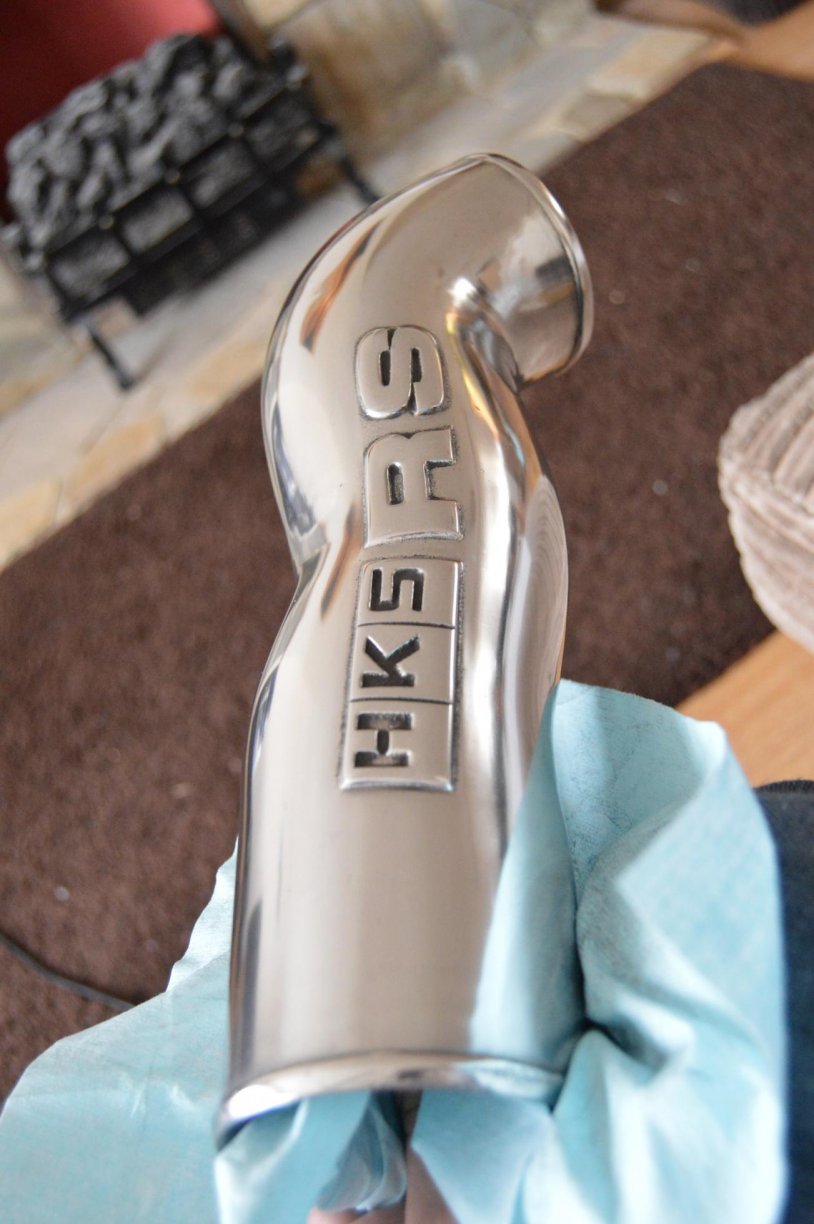

Today was my day off and I didnt have time to tackle any massive jobs so spent a few hours polishing the HKS RS pipe back up, must say im very happy. Still undecided weather to sell it on or keep (will probably fit it).
Some pictures, first I used 100 grit sandpaper on a hand sander and a dremel with 100 grit drum sanders to get the horrible deep scratches and wear marks out of it. Them I slowly stepped up the grades to a wet and dry 1200. Finished with 3 stages of 3m compounds and a last stage of Kleers metal polish both on the machine, dremmel for the fiddly corners and by hand.
All the marks are removed and its looking a lot better.
