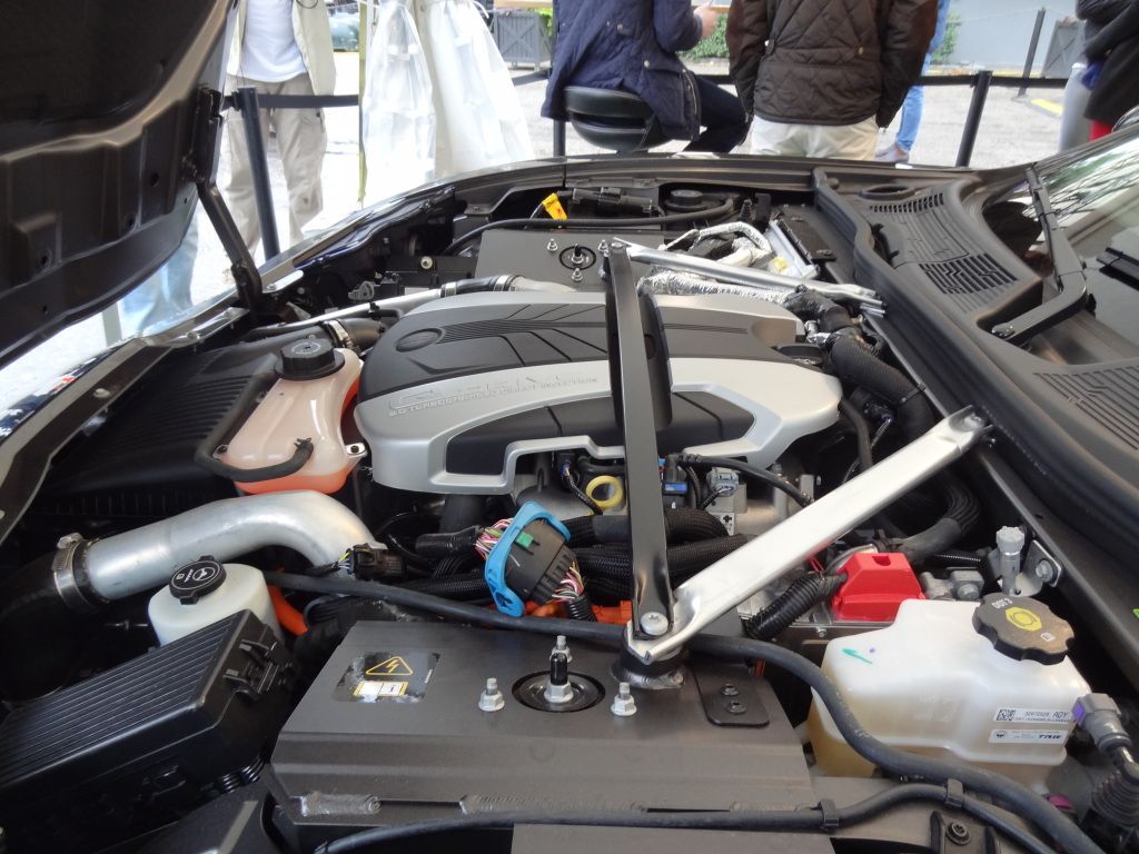

SPG Posted January 3, 2013 Share Posted January 3, 2013 I was looking through my Stockholm pics and noticed that a few of the standard factory cars have triangulated braces like the Fisker Karma below Link to comment Share on other sites More sharing options...
Westy Posted January 3, 2013 Share Posted January 3, 2013 I went with the Carbing as well, the rear one actually bolts to the floor as well as the Struts I went with the DoLuck rear for this same reason! I was looking through my Stockholm pics and noticed that a few of the standard factory cars have triangulated braces like the Fisker Karma below http://i1201.photobucket.com/albums/bb343/Suprasun1996/DSC03084_zps62682e93.jpg MR2s have triangulated braces like this so it's nothing new...I'd say a decent set of ARBs would be more beneficial, but I fitted the strut braces as I like the way they look. Link to comment Share on other sites More sharing options...

Chris Wilson Posted January 4, 2013 Share Posted January 4, 2013 Unless it's welded in, or a really stout triangulated structure it's not going to do anything worthwhile. Most are just expensive shiny bits. The Aristo factory bar looks quite well made, as you would expect. The Fisker attempt looks typical expensive kit car afterthought, and not something they should be very proud of Link to comment Share on other sites More sharing options...
