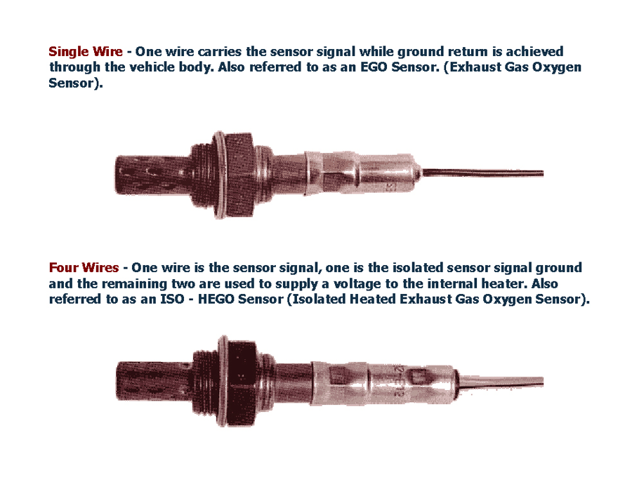

I would be interested to know if the one wire sensor from the N/A is actually just a temp sensor like the TT, i thought a true lambda sensor needs a signal wire and an earth wire, but maybe it uses the sensor body as earth?
Edit, just found this so i guess its the body thats the earth.
http://www.lambdasensor.co.uk/main/mcolours.htm
and this, http://www.omnitekcorp.com/images/1wire4wire.gif
