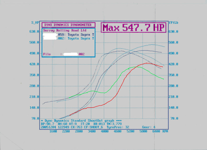

Homer Posted October 23, 2006 Share Posted October 23, 2006 Gaz, what you're saying is pretty much spot on, Terry's car has so much more torque through the mid range it's almost unbelievable, However after being out in Wez's car and seeing the dyno plot, it has even earlier spool (!!), though less top end. I'll sort an overlay graph shortly. I'd like to see a BPU car with atleast an Emanage overlaid with Terry's car, or a basic single vs Homer's. Give it a couple of weeks and my budget single should be on the road. Its a reasonably large turbo being a T67, but should come in at less than £2k all in (plus diy 'driveway' install). It'll be off to SRR for a dyno run as soon as its mapped so will get them to plot against previous stages of modification (Charlie has all the history saved in their computer). Quote Link to comment Share on other sites More sharing options...

Gazboy Posted October 23, 2006 Share Posted October 23, 2006 Give it a couple of weeks and my budget single should be on the road. Its a reasonably large turbo being a T67, but should come in at less than £2k all in (plus diy 'driveway' install). It'll be off to SRR for a dyno run as soon as its mapped so will get them to plot against previous stages of modification (Charlie has all the history saved in their computer). That should make very, very interesting viewing, as I assume all that's changing is the method of asperation? Quote Link to comment Share on other sites More sharing options...
Homer Posted October 23, 2006 Share Posted October 23, 2006 For those that were interested here's BPU vs Wez's PHR stage 1 vs Terry's T61 dbb: PHR stage 1 = dark blue T61 dbb = light blue Jspec BPU = Red and green Its by no means a scientific test but gives a rough idea of the difference between small/mid single and BPU. Quote Link to comment Share on other sites More sharing options...

Gazboy Posted October 23, 2006 Share Posted October 23, 2006 Only the turbo (entire exhuast side stuff) and the injectors are being changed, plus the ECU. That's a damn shame for comparison purposes. Wez's car looks fantastic! It's odd that your first turbine appears to be doing the square root of fuck all according to the graphs- I wonder why that appears to be the case, and would this hold true if both you and Wez did a side by side test from 30-40-50 (as low as possible) in 6th if you'll remain side by side as the graph dictates until Wez leaves you for dead at 3000rpm? Hypothetically speaking. Quote Link to comment Share on other sites More sharing options...
Homer Posted October 23, 2006 Share Posted October 23, 2006 Not sure what you mean Gaz, you can't go single without an ECU change. It'd be a worthless comparison between BPU and single anyway since a single must have a full remap for it even to start up/idle, let alone run on boost. Edited to add: what I mean is a BPU car has a stock ECU, a single must have an aftermarket ECU (whether standalone or piggyback is irrelevant). Its impossible to compare BPU and single using the same ECU as it'd have to have a complete remap/upgrade to work. The conversion I'm doing is the most basic you can get so it's a fair comparison between good BPU and base spec single. Quote Link to comment Share on other sites More sharing options...
