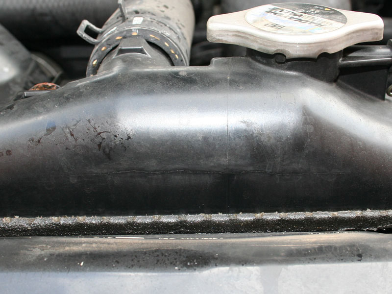

Some people have reattached the air duct that sits on top of the fan cowling to supply cold air to their induction kit. How? If I can't do this soon then it's bye-bye apexi to one of you guys! ;)
Its held on with one bolt on a bracket on top of the radiator.
