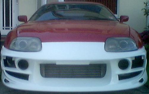

I've had my bomex fitted for about a month now and was done by a friend. The driver's side is fine but the passenger's side sticks out slightly. Im currently trying to find a pic on my pc but only have them at home. It looks like the corner of the bumper should be bolted to the arch lining, but feels very tight when you push it in to line it up.

im glad im not alone. i fitted mine today and it was a nightmare!! the first problem was cutting down the scoop to clear the intercooler. once i got it right i had do make the holes on the sides to use the original bolting plates. i got the holes spot on bit it seems like the holes above the nose cone are out. i tried lining up the nose cone first the do up the nuts on the side but now the passenger side sticks out and leaves a fair size gap to the inner arch, the drivers side is perfect. even though the shut lines for the bonnet look good and the fitment around the lights and wings look good, i still think that having to force it slightly has warped it. im gonna have another go at the weekend so i'll post again if i have any luck..
i've attached a picture but it doesnt show very well

i finnished work early so i thought i'd take it off again. with the bumper off the car its still out of shape. i thinks im just gonna have to get the hack saw and resin to it. my old mans worked with fibreglass for years and thinks my bumper was taken out the mould to early before it had cured.. cheap crap!! he thinks there might be a way of cutting a few slits in the bottom lip, re possition it then glass it again. it should work he thinks, i'll let you know how it goes.

Sorrry mate - but I dont reckon there is much you can do - split the bottom and cut a wedge out to allow it to be forced in...???
If you are down there - I have a chap who could look at it for you - but prognosis not good... :(
