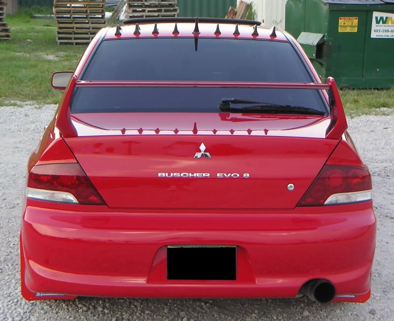

I would have thought rear wings would work best with a clean uninterupted flow of air, the roof scoop must be disturbing the air to the rear wing surely. As above, I thought the roof scoop on rally cars was air to the cabin, roof scoops on a GT car was air to a mid mounted engine (NSX). There is more convincing science applied to the row of small shark fins on the aft edge of the roof on some Evos etc, which is supposed to aid air flow to the rear wing.
I was thinking about those shark fin things. My understanding of them is that they act like vortex generaters on plane wings - they induce turbulence into the flow, which allows the flow to remain attached to the surface of the car for longer, which should in theory cause more flow down the rear windscreen, and onto the rear wing. Which should create more downforce.
