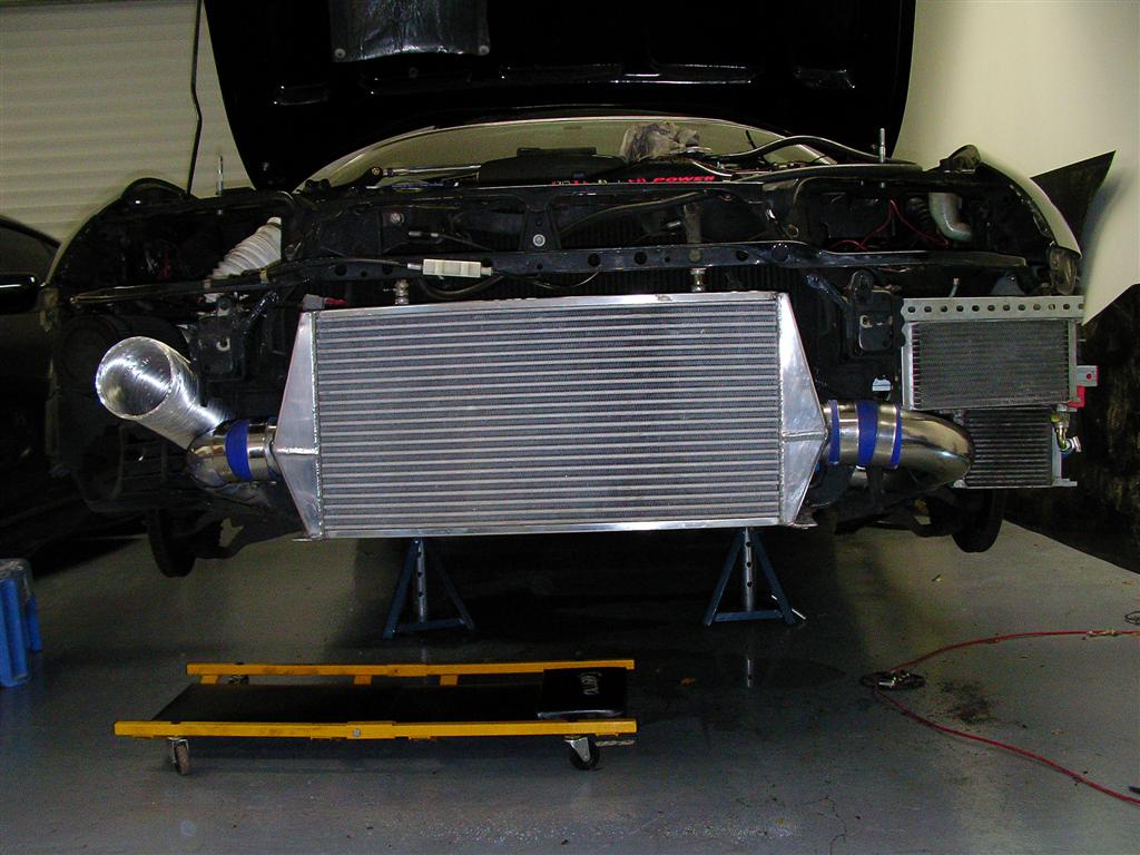

paul mac Posted April 20, 2006 Share Posted April 20, 2006 Got some fans and the new thermostats that i will try and put on tomorrow. They fit perfect between the fmic and the auto coolers. Have even decided to get a fan for the oil cooler too now james these look suspiciously like cabinet cooling fans are you sure they'll handle getting piss wet through Quote Link to comment Share on other sites More sharing options...
Lucifer Posted April 20, 2006 Share Posted April 20, 2006 james these look suspiciously like cabinet cooling fans are you sure they'll handle getting piss wet through True these ae not sealed units. and certainly will not move enough air for a tranny cooler. Just take a look at teh CFM rating. The Spal 7.5 we sell moved 520CFM. Not trying to sell anything, just dont want to anyone to burn their tranny (vestive) Quote Link to comment Share on other sites More sharing options...
terribleturner Posted April 20, 2006 Author Share Posted April 20, 2006 They are splash proof fans and are good for 169.9cu.m/h. Would be nicer to have more air going through but should be fine we these puppies plus got them for free and couldn't find an others. May have another search around though quickly. Quote Link to comment Share on other sites More sharing options...

paul mac Posted April 20, 2006 Share Posted April 20, 2006 (edited) True these ae not sealed units. and certainly will not move enough air for a tranny cooler. Just take a look at teh CFM rating. The Spal 7.5 we sell moved 520CFM. Not trying to sell anything, just dont want to anyone to burn their tranny (vestive) good point here mate i used to use a lot of these cabinet fans in a previous job and the air they move is piss poor compared to a spal, please note i have edited the post where i quoted stat part number from RS this was for a normaly closed contact (wrong) should have been normaly open, the number in the thread now is for a 75 degree stat i have lost the packet for the 70 degree one but am sure i can get the number if anyone wants it Edited December 29, 2008 by paul mac tidy up of info (see edit history) Quote Link to comment Share on other sites More sharing options...
Lucifer Posted April 20, 2006 Share Posted April 20, 2006 They are splash proof fans and are good for 169.9cu.m/h. Would be nicer to have more air going through but should be fine we these puppies plus got them for free and couldn't find an others. May have another search around though quickly. I hope you are ducting all that as putting all that infront of your RAD is not doing much for water cooling. Quote Link to comment Share on other sites More sharing options...
b_have Posted April 20, 2006 Share Posted April 20, 2006 Spent many late nights trying to find positions for my coolers. Really didn't want to steel any cold (fmic warm) airflow from the rad so squeezed two in the nearside matching my Bomex intakes. I use the offside flow for an external mount for my K&N and below that I have ducted feed to cool the compessor hsg.- Quote Link to comment Share on other sites More sharing options...
Lucifer Posted April 20, 2006 Share Posted April 20, 2006 Spent many late nights trying to find positions for my coolers. Really didn't want to steel any cold (fmic warm) airflow from the rad so squeezed two in the nearside matching my Bomex intakes. I use the offside flow for an external mount for my K&N and below that I have ducted feed to cool the compessor hsg.- That's the way to do it. If I had my way, anything over 400bhp would have the condenser removed too. Unless your RAD is in its top 20% of its life, it needs all teh help it can get at high BHP. As we ALL know, heat kills... Quote Link to comment Share on other sites More sharing options...
terribleturner Posted April 20, 2006 Author Share Posted April 20, 2006 Spent many late nights trying to find positions for my coolers. Really didn't want to steel any cold (fmic warm) airflow from the rad so squeezed two in the nearside matching my Bomex intakes. I use the offside flow for an external mount for my K&N and below that I have ducted feed to cool the compessor hsg.- See i'd like to have put the auto coolers where you have your ducting but they're just not gonna fit. Im better of ducting the air there to the rad. I'll just have to get the single on and then see what's what and adjust the best i can Quote Link to comment Share on other sites More sharing options...

Lucifer Posted April 20, 2006 Share Posted April 20, 2006 What coolers do you have, i its those Mocal ones in the photo they do fit, you jest need to jiggle them. I have a photo of my old road car around somewhere with 3 on. Quote Link to comment Share on other sites More sharing options...
terribleturner Posted April 21, 2006 Author Share Posted April 21, 2006 Yeah both 13 row Mocal coolers. I could always get a new fmic pipe fabricated to be out the way but im playing with the idea of a 4 row to go in at the moment. I'll have another look tomorrow. Quote Link to comment Share on other sites More sharing options...
Lucifer Posted April 21, 2006 Share Posted April 21, 2006 It is best not to put the coolers in the way. Go one... get rid of teh air con. Quote Link to comment Share on other sites More sharing options...
