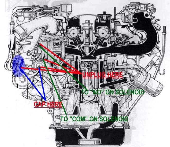

XtSupra Posted October 21, 2005 Author Share Posted October 21, 2005 I actually do have Greddy Profic B II installed, but the last owner had it unhooked, so I guess I will go ahead and install that. but let me go over the installation with you guys. I will have to unhook the 2 hoses going to the black stock thingy (V somthing or I would guess stock boost controller) and cap these 2 nipples, the hook one side of the controller to the top nipple of the golden WG and cap the bottom nipple on the WG, and hook the other side of the Greddy to the nipple on the Turbo's intake hossing (pressure line), and the rest I am sure I can manage. so simply I control the boost going from the Turbo's pressure side in the turbo's intake housing to the top nipple of the stock WG, and cap the bottom nipple on that WG. right? thanks for your help guys. Link to comment Share on other sites More sharing options...
Jake Posted October 21, 2005 Share Posted October 21, 2005 Here you go : Link to comment Share on other sites More sharing options...
Chris Wilson Posted October 21, 2005 Share Posted October 21, 2005 There are some turbo trouble shooting articles and pics somewhere on this forum, that show just how the stock piping should run. Put it back to stock, with no cats you neither need nor want a boost controller, you may need to artificially DROP the boost ( a boost controller can only Raise the boost above wastegate spring pressure, not lower it), by restricting the exhaust to keep below 1.2 bar. Link to comment Share on other sites More sharing options...
XtSupra Posted October 21, 2005 Author Share Posted October 21, 2005 Jake, thanks alot for the PIC bro, so I guess I was right afterall. I will try to hook up the boost control and see if that help. Chris, thanks too bro, I do know that boost controler will never drope the boost below the WG spring's rate, I just think that the stock boost controller is not doing it's job as it should, I mean I might have a pressure leak or something that causes it to over boost, and this is why I wanted to try the boost controller that I already have before going into adding cats or putting the stock downpipe back on since I really don't have any stock exhaust parts for this car (bought it with aftermarket downpipe and catback) a question that I already asked eariler is, since most people agree on MAX safe boost with stock turbos, stock fuel system, and stock SMIC on a pump gas (92-93 Octane) is around 1.2bar , well I have FMIC and I run 98 octane gas, does that rule still applies to me, I mean does not running FMIC and higher octane gas allows you to run a bit more boost safely? and finally, where do you guys mount your EGT gauges, which runner is what I am looking for, or should I mount it on the downpipe right after the turbos? thanks a lot guys, I really appreciate the help. Link to comment Share on other sites More sharing options...
