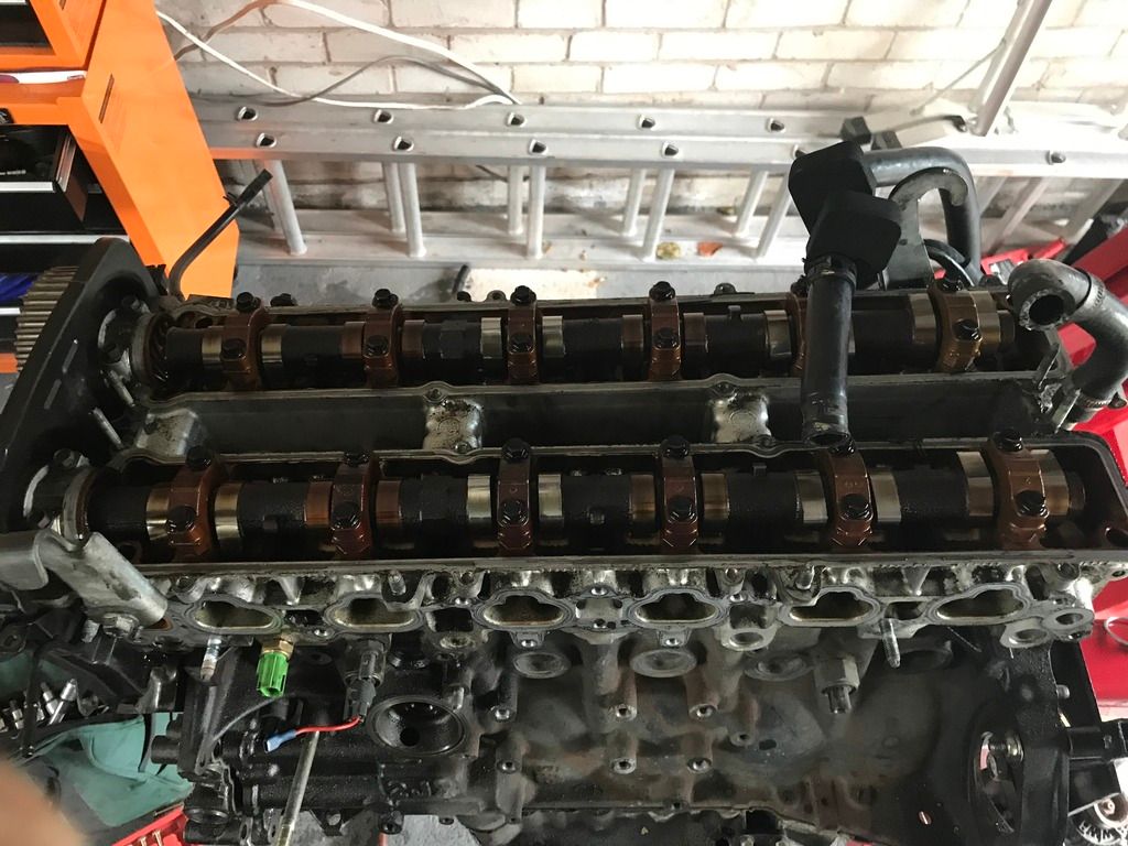

Engine and Gearbox was pulled on Saturday and I can now see why the auto box was slipping and so sluggish, it had next to no fluid in it! Engine has been badly bodged at some point in its life with incorrect bolts used to screw the water pump together and rubber gunk used to seal the cam covers - hence why there is more oil on the outside of the engine than the inside.
Luckily none of which matters to me as I'm only after the block and a few of the bolts for when I come to put it all back together as a GTE.
Engine is now in strip down and after a few more bits tonight its mostly in parts. Stuck now as need an impact gun for the cam pulleys as they have been done well past their required torque or locktighed in.

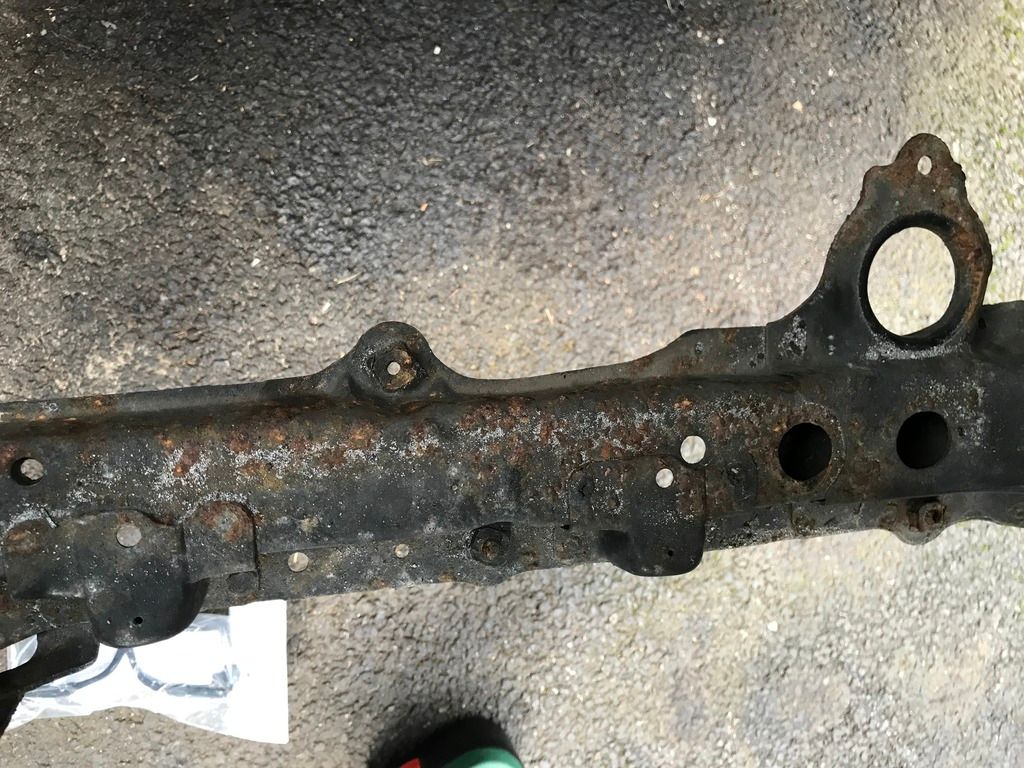

Busy weekend on the car. Got the engine bay fully stripped down, back to metal and primed.
Before work
during Stripping and rust treatment
After a couple of coats of rust treatment and primer
Now a few more coats of primer, Wet sand back and ready for paint.
