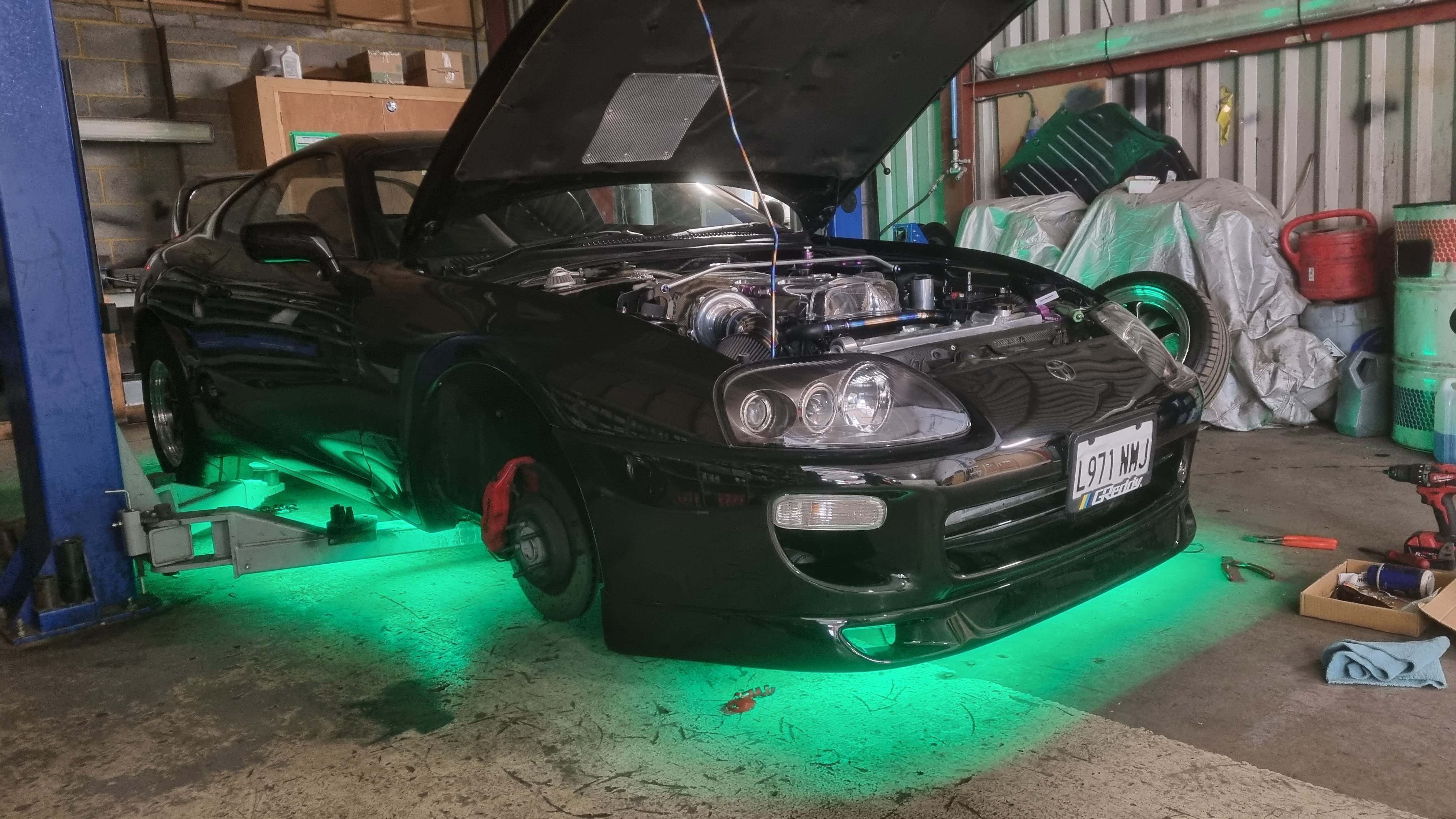

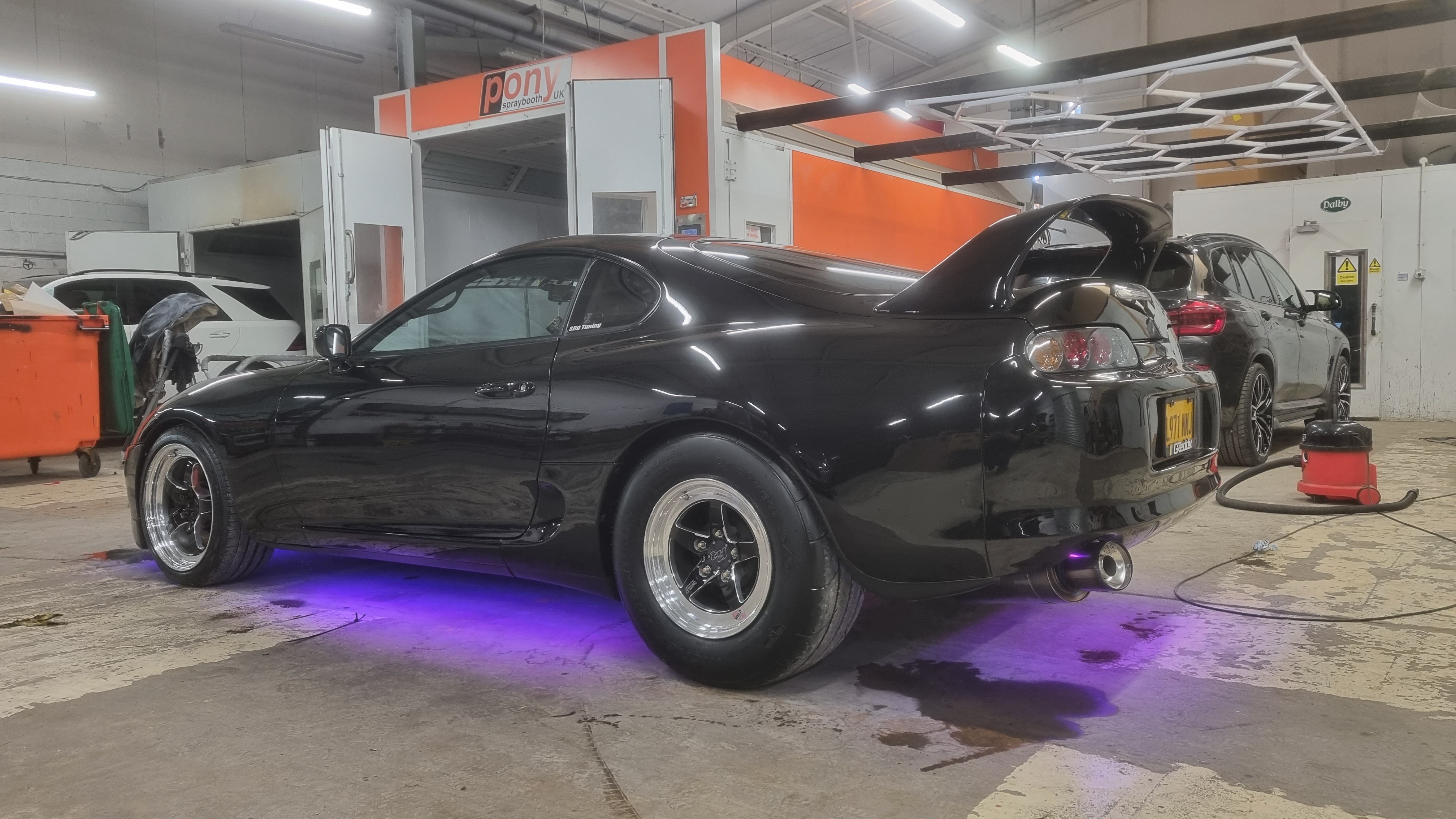

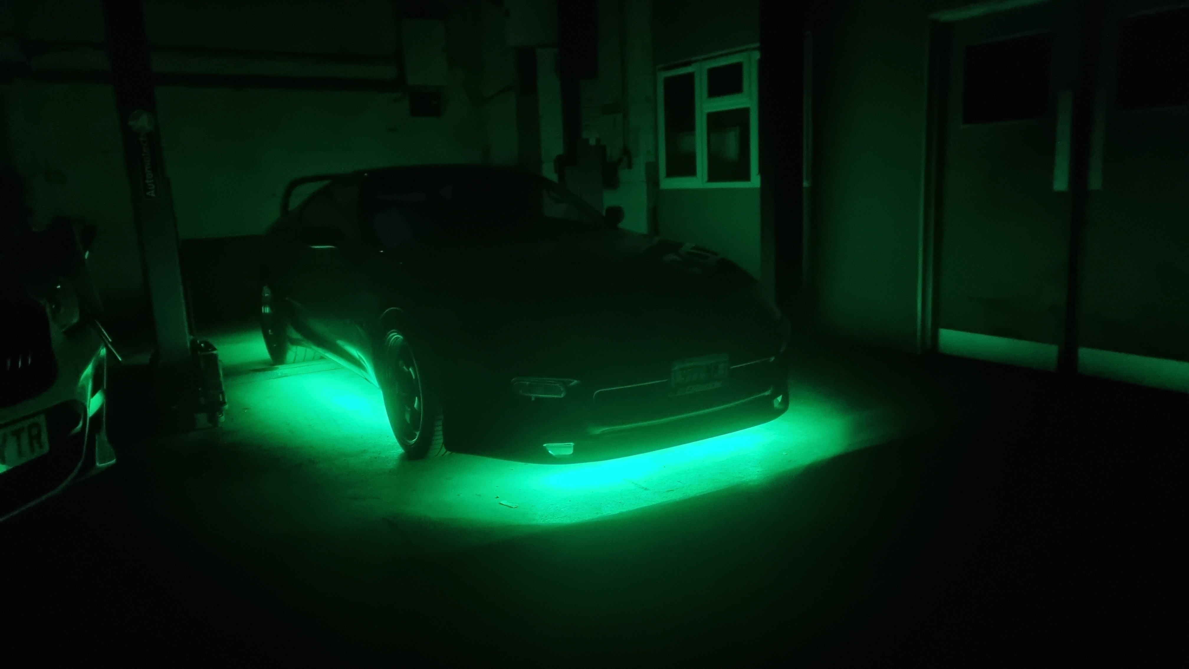

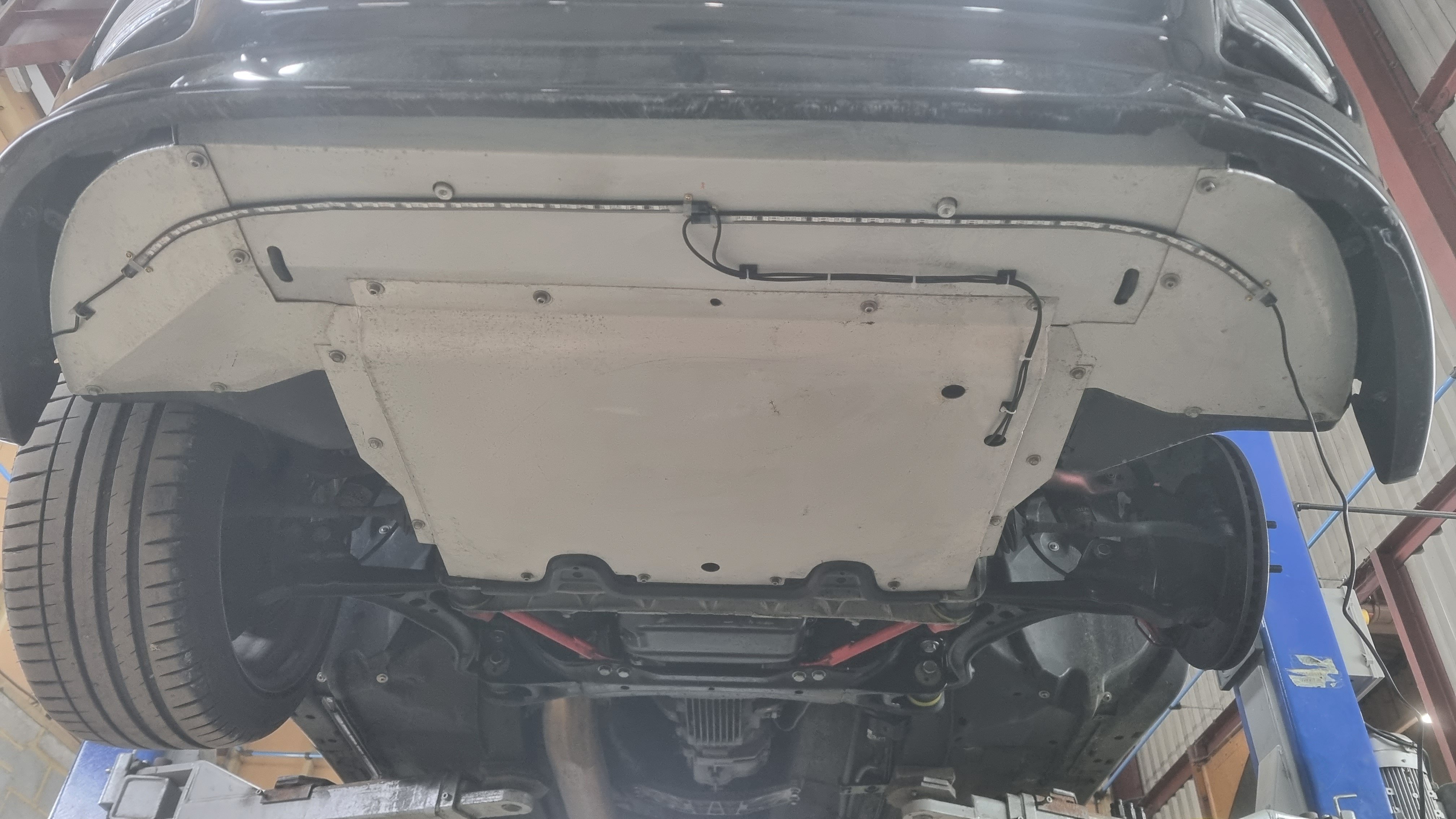

After getting the prop back on i then started to look at how i was going to go about installing the under glow 😁

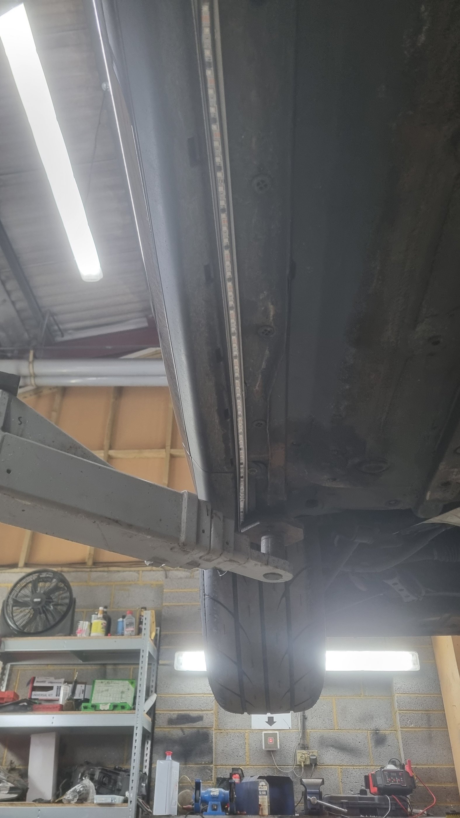

2 things are for certain. First of all i absolutely do not want to be able to see the actual strips and secondly i refuse to bodge this - like every single underglow installation I've every seen. For some reason people just seem to cable tie it where ever they can or screw it into the floor with zero sympathy for the car.
Im going to make proper tracks for it to sit in using angle tray. Keeping it neat, not drilling additional holes into the car and not allowing the strips to be visible.
So i bought some 10mm x 20mm aluminium angle tray and made a start on the rear bumper strip
I removed the rear bumper lower strip that attaches the bumper to the fuel tank protector and riveted the tray into those holes.

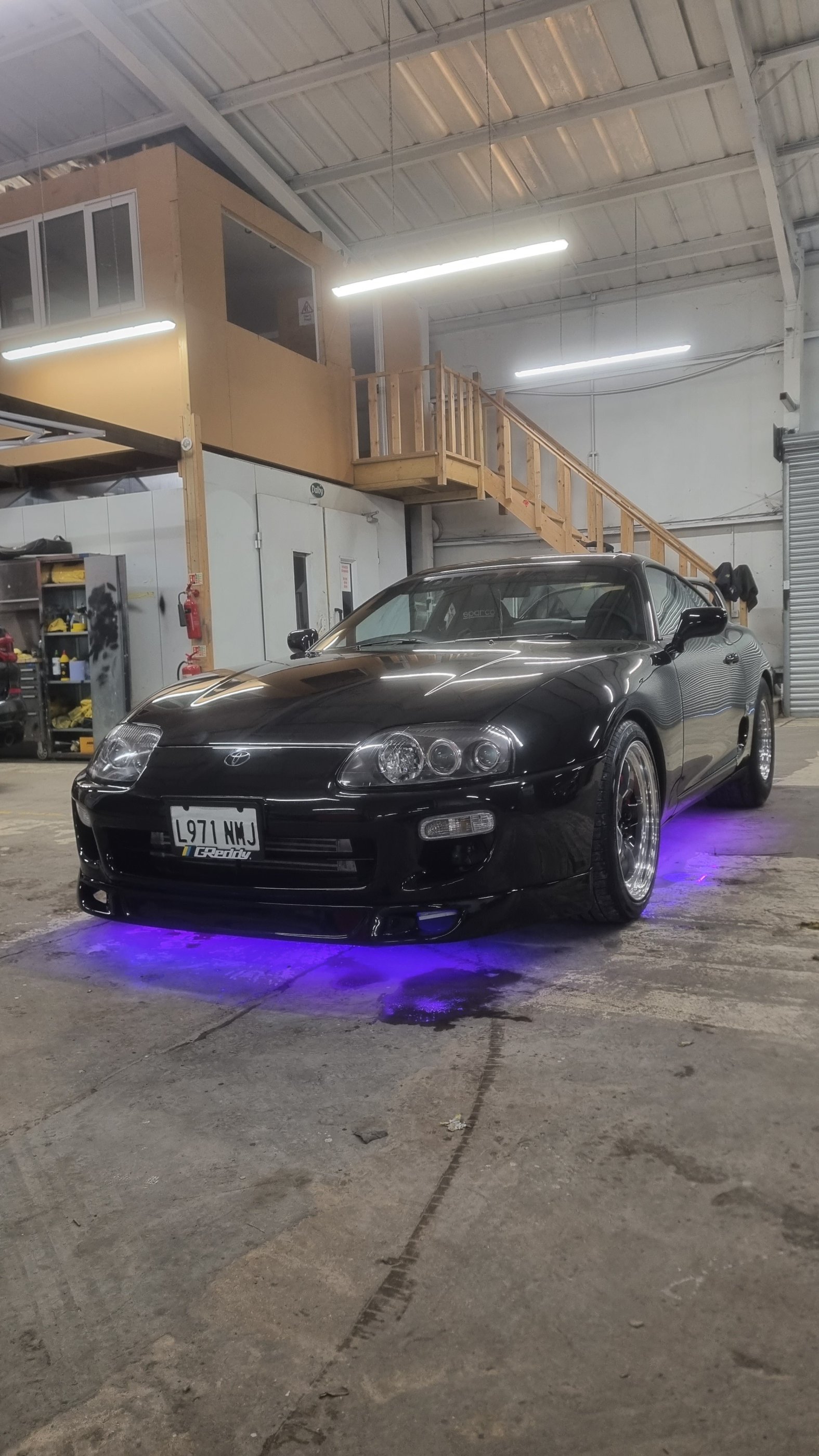

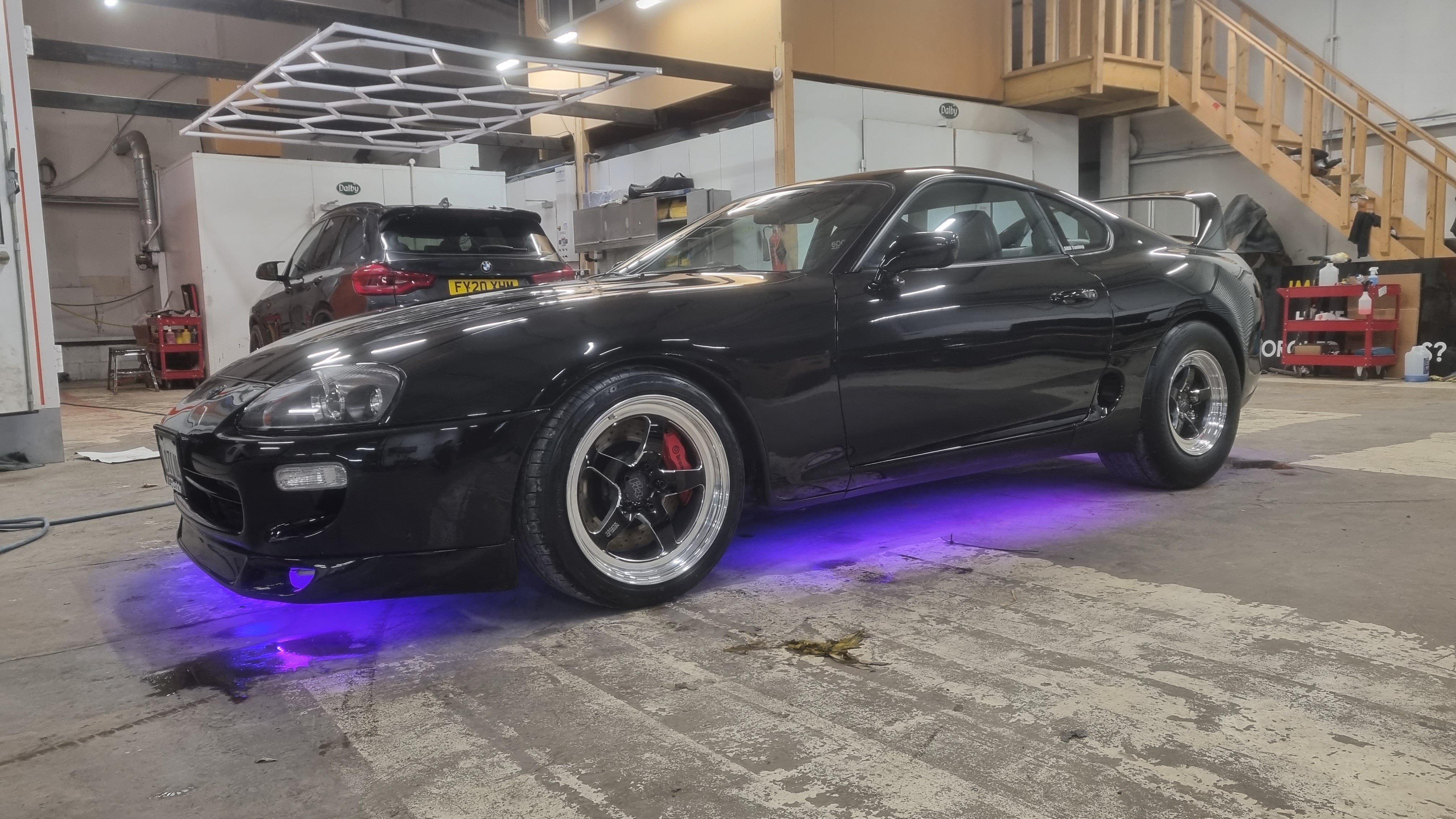

Sooo, first of all, just following on from my previous post. Underglow is done.
  • Like 2

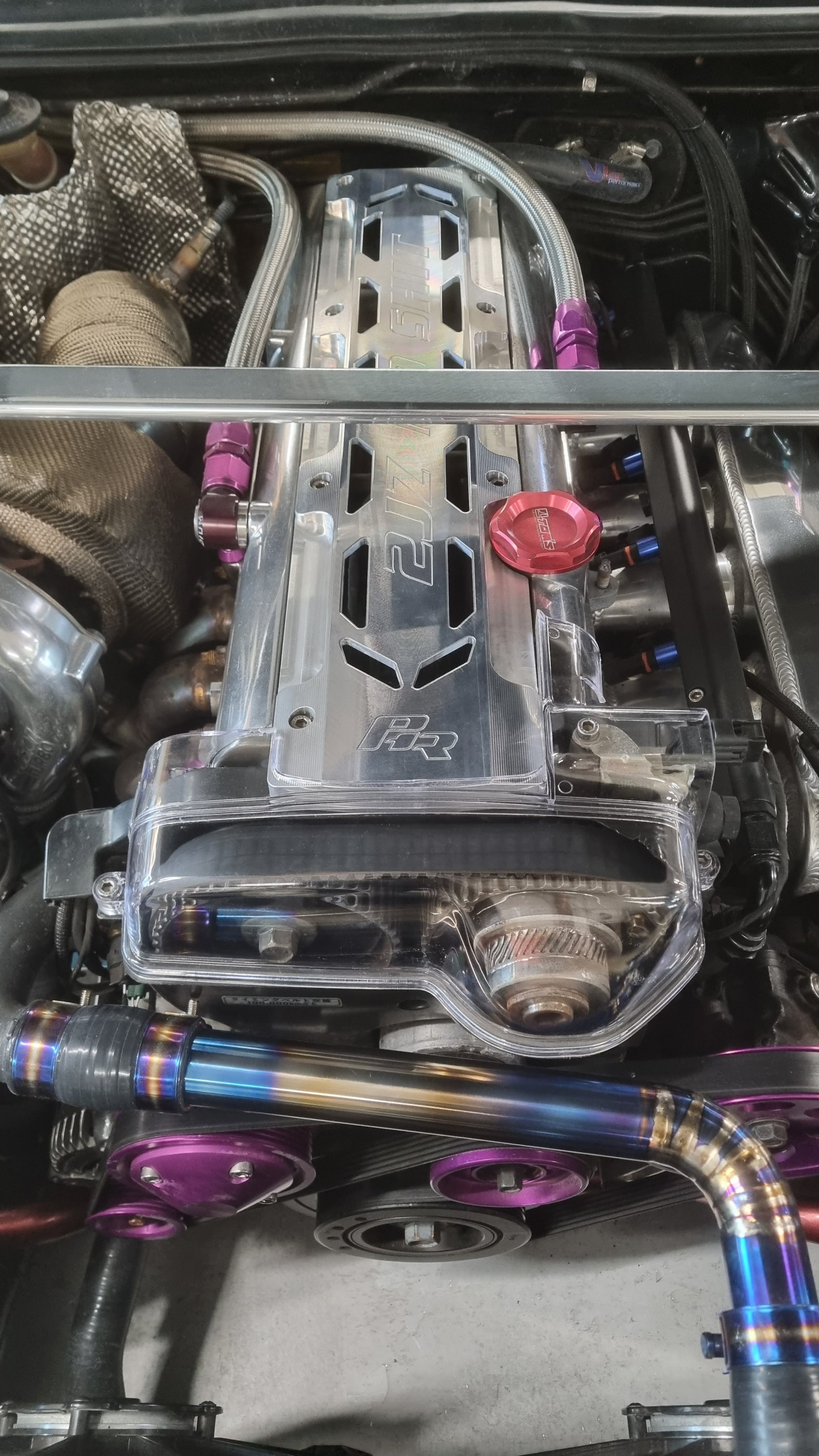

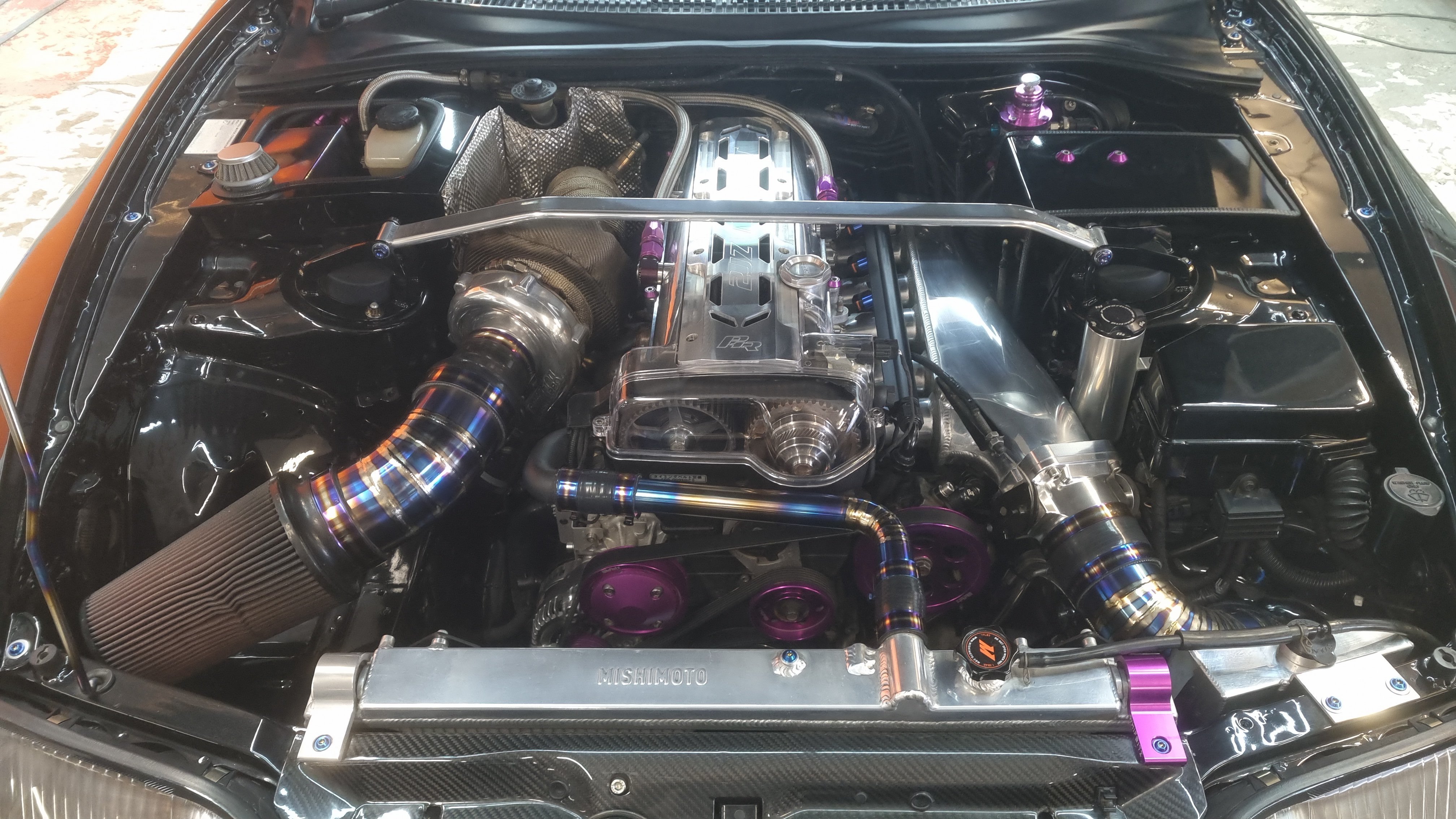

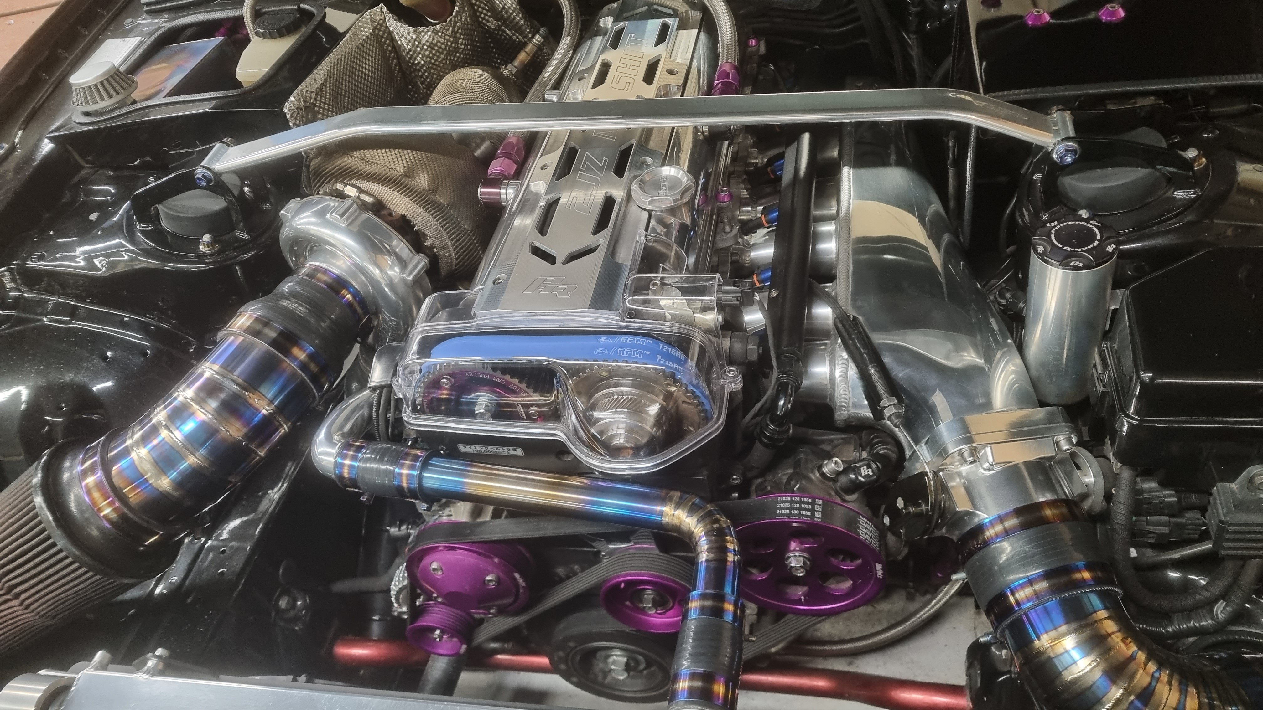

Secondly.. a little bit more engine bay bling. I purchased a PHR billet spark plug cover and clear upper timing belt cover from Sheefa. I absolutely love it. Made me realise how much i hated the black spark plug cover i had previously.
Polished my oil filler cap too and one of the rad brackets.. still need to get round to doing the other side!

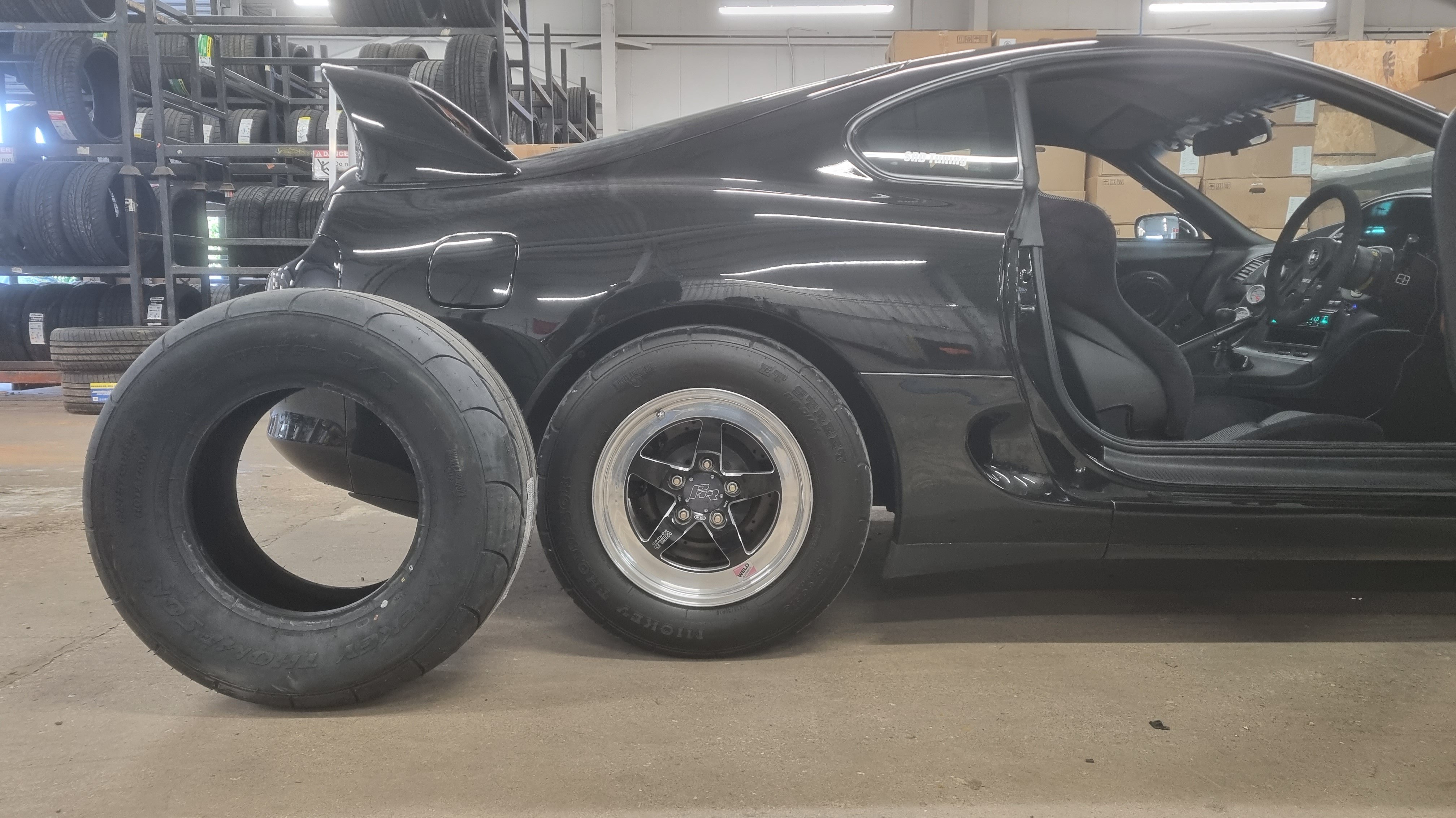

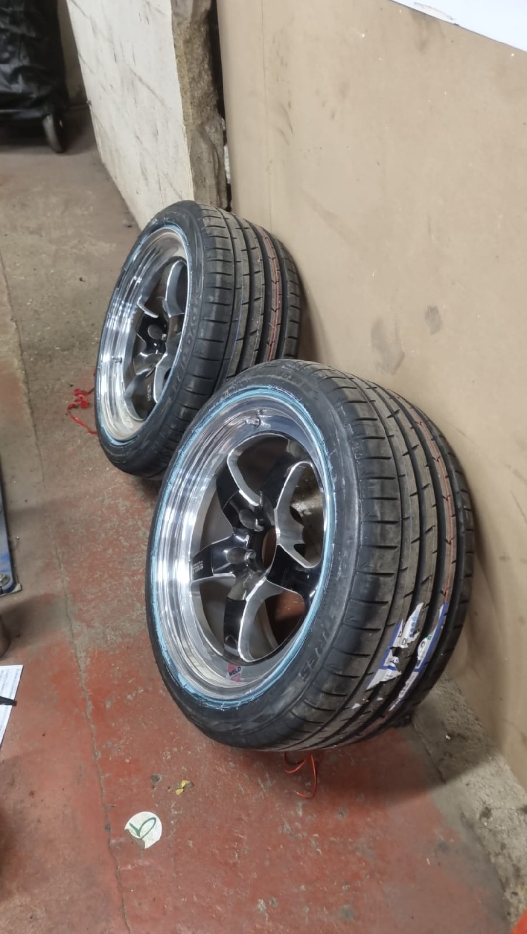

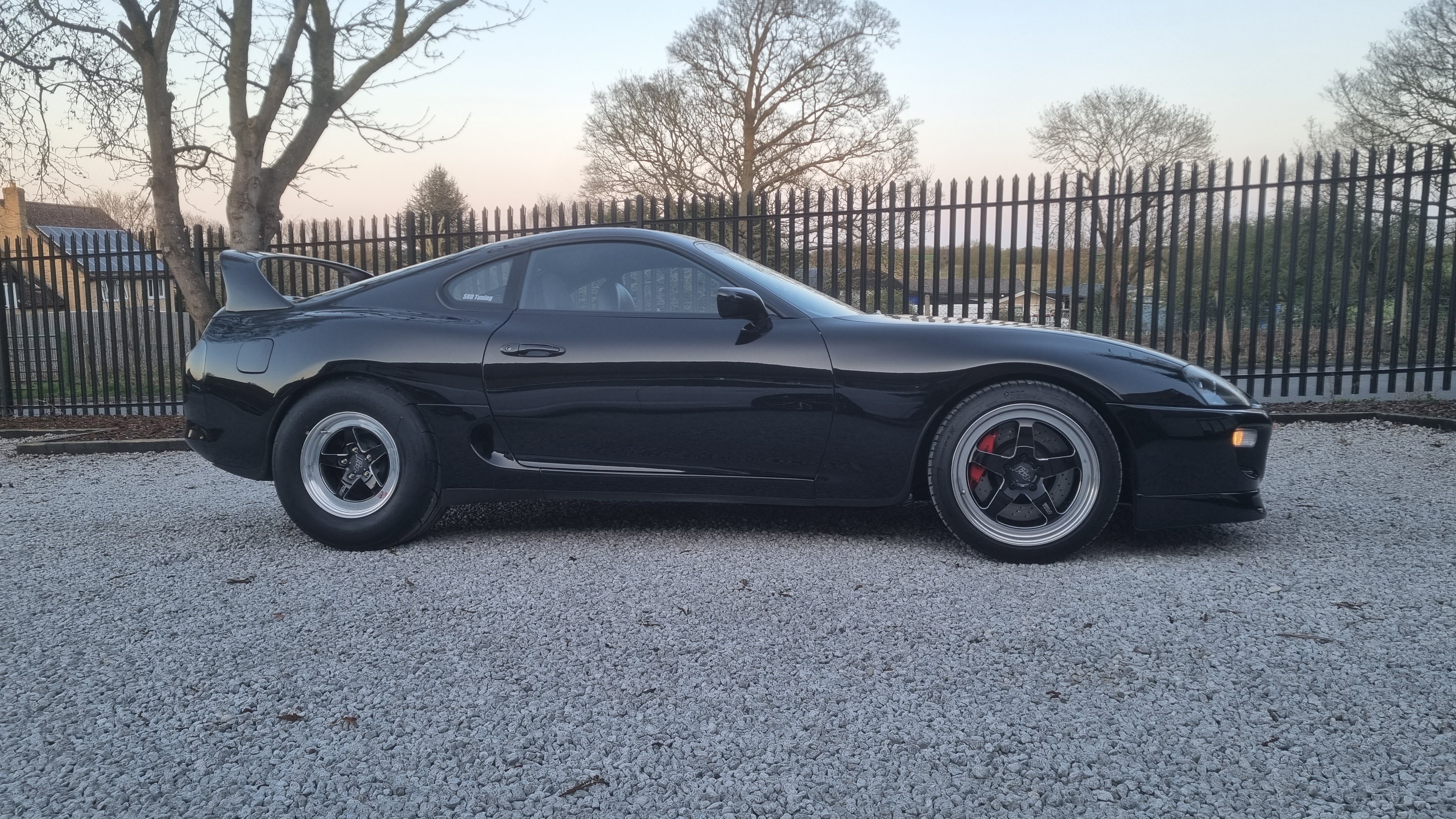

Thirdly, bigger tyres!

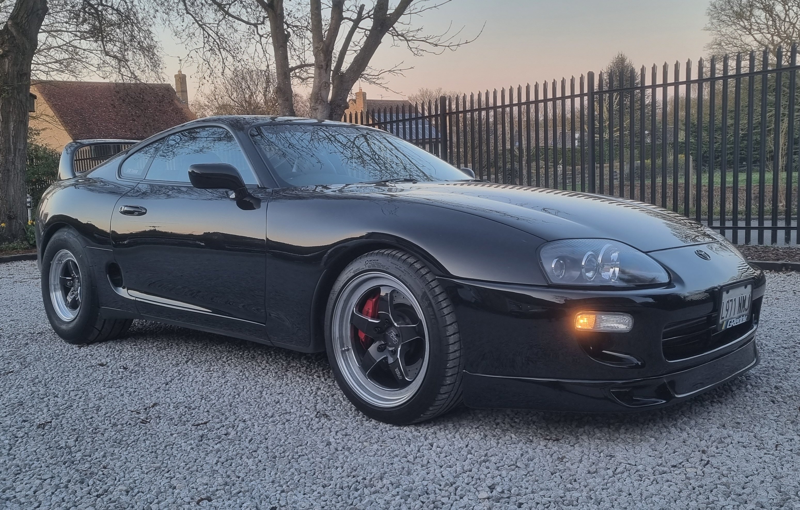

I was due a new set of tyres. I went for Toyo Proxies on the front and another pair of Mickey Thompsons on the rear... but this time i went bigger. Rather than the previous 275 50s, i opted for 275 60s. Significant size increase.
The gearing has also been noticeably lengthened. 2nd gear now will now do 75mph. Traction is also drastically improved - i dont have traction control and i dont have boost by gear, 780bhp and i can put all of that to the road in 2nd. No wheel spin.

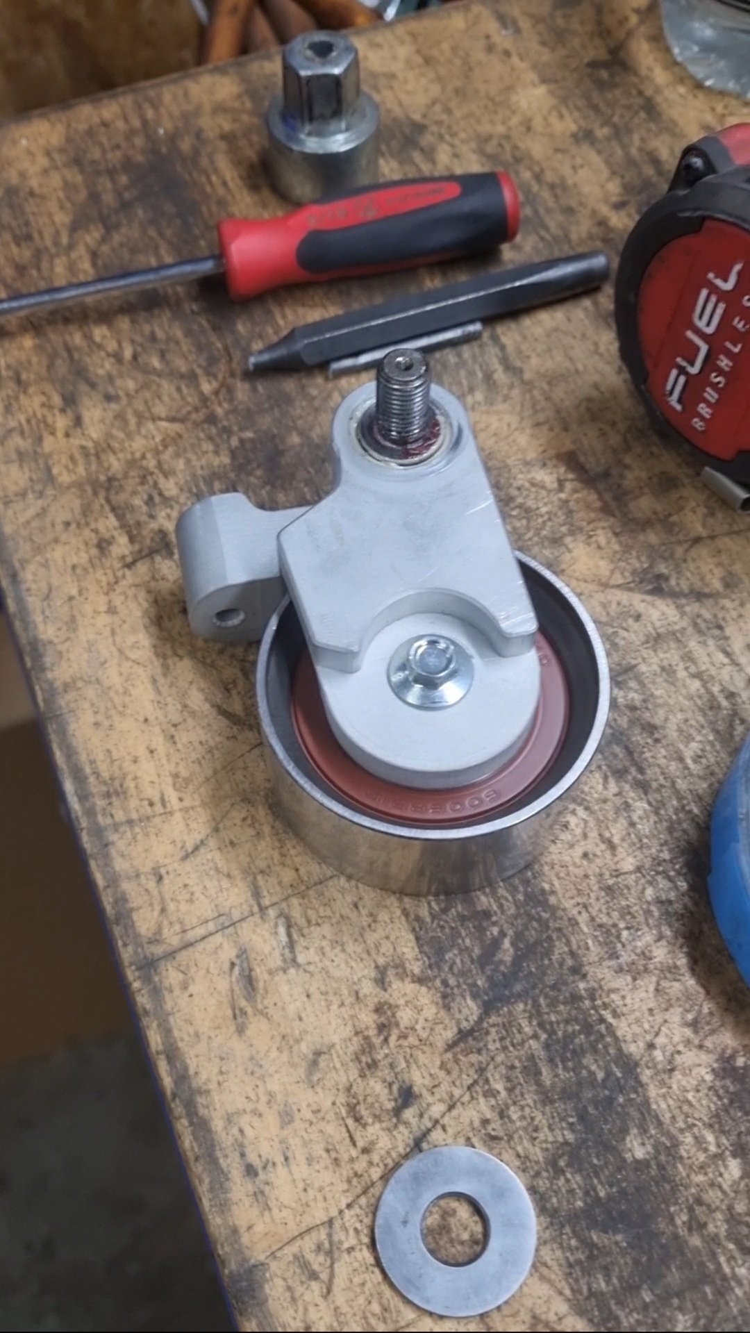

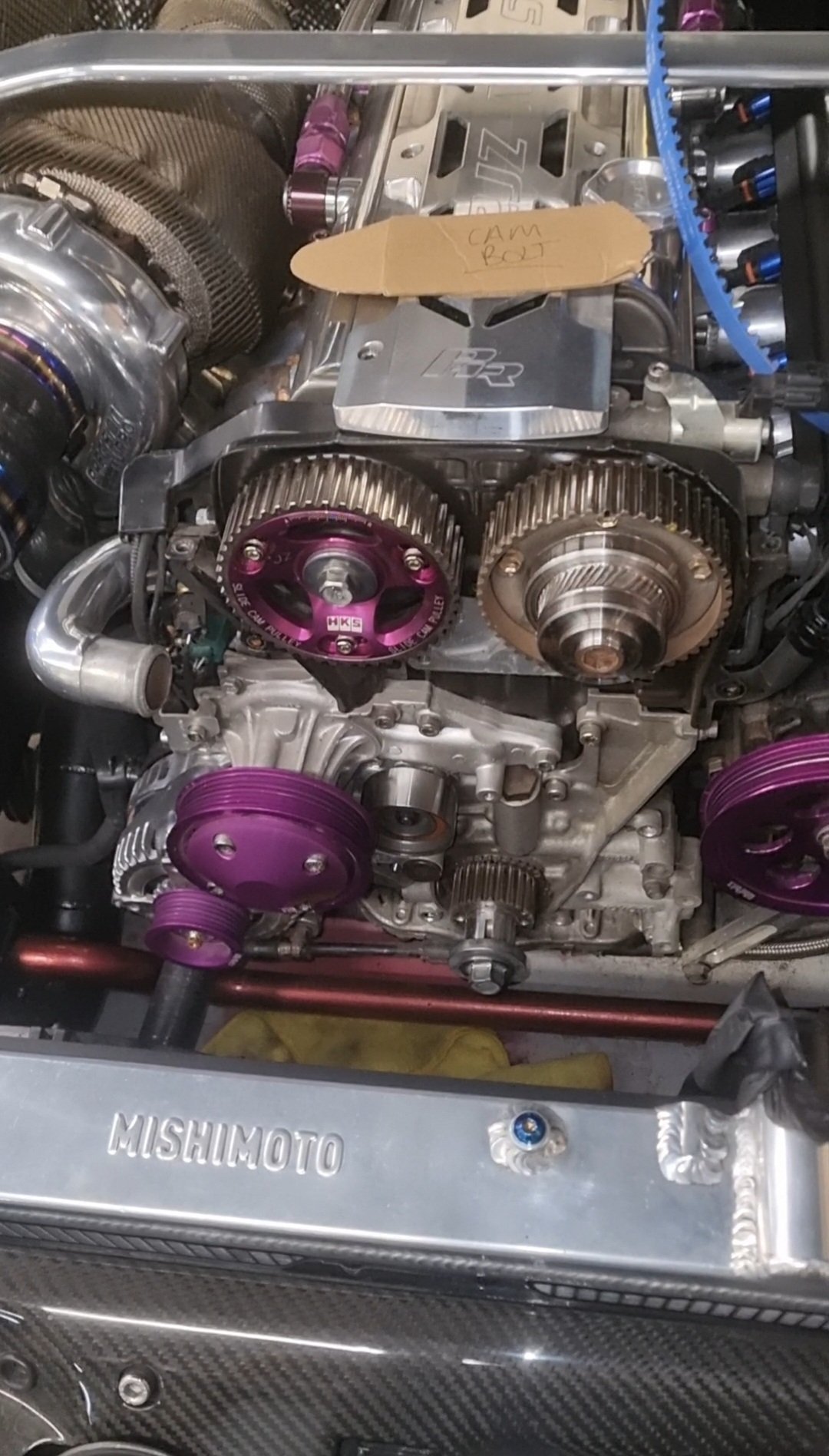

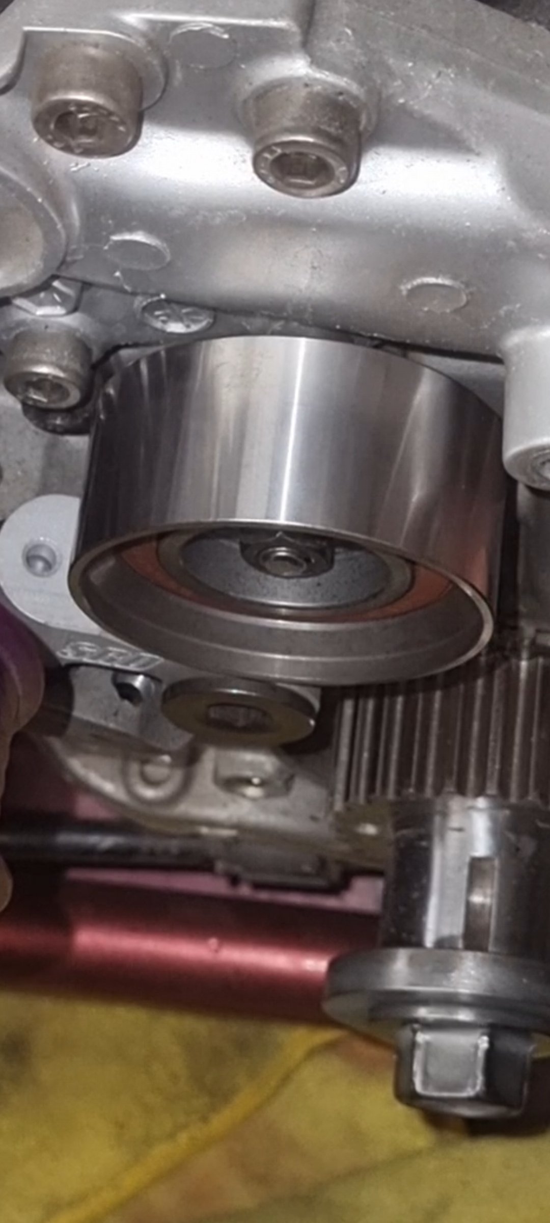

Fourthly... timing belt, cam pulley and tensioner bracket.
I had the whifbitz tensioner bracket, but became aware that the lack of a bronze bush inside of it can create an issue. Also, the recent clear timing belt cover was crying out for a fancy cam pulley and coloured timing belt.
I already had a brand new HKS cam gear and i bought a gates racing timing belt and SRD billet tensioner bracket that Lee kindly supplied with a new pulley too.

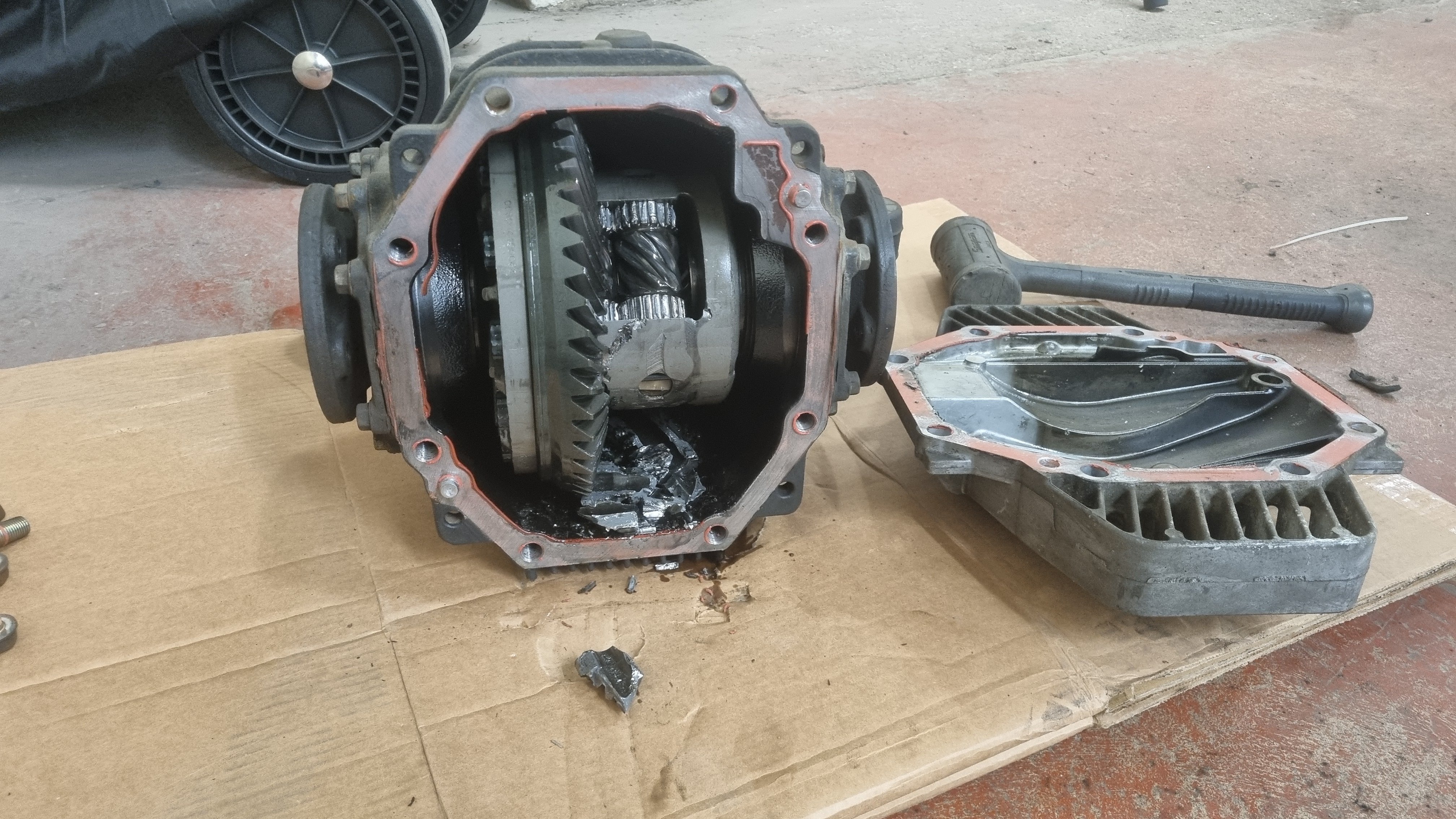

And last, but by no means least.. the detonation of my big case B03B diff! 😩😆

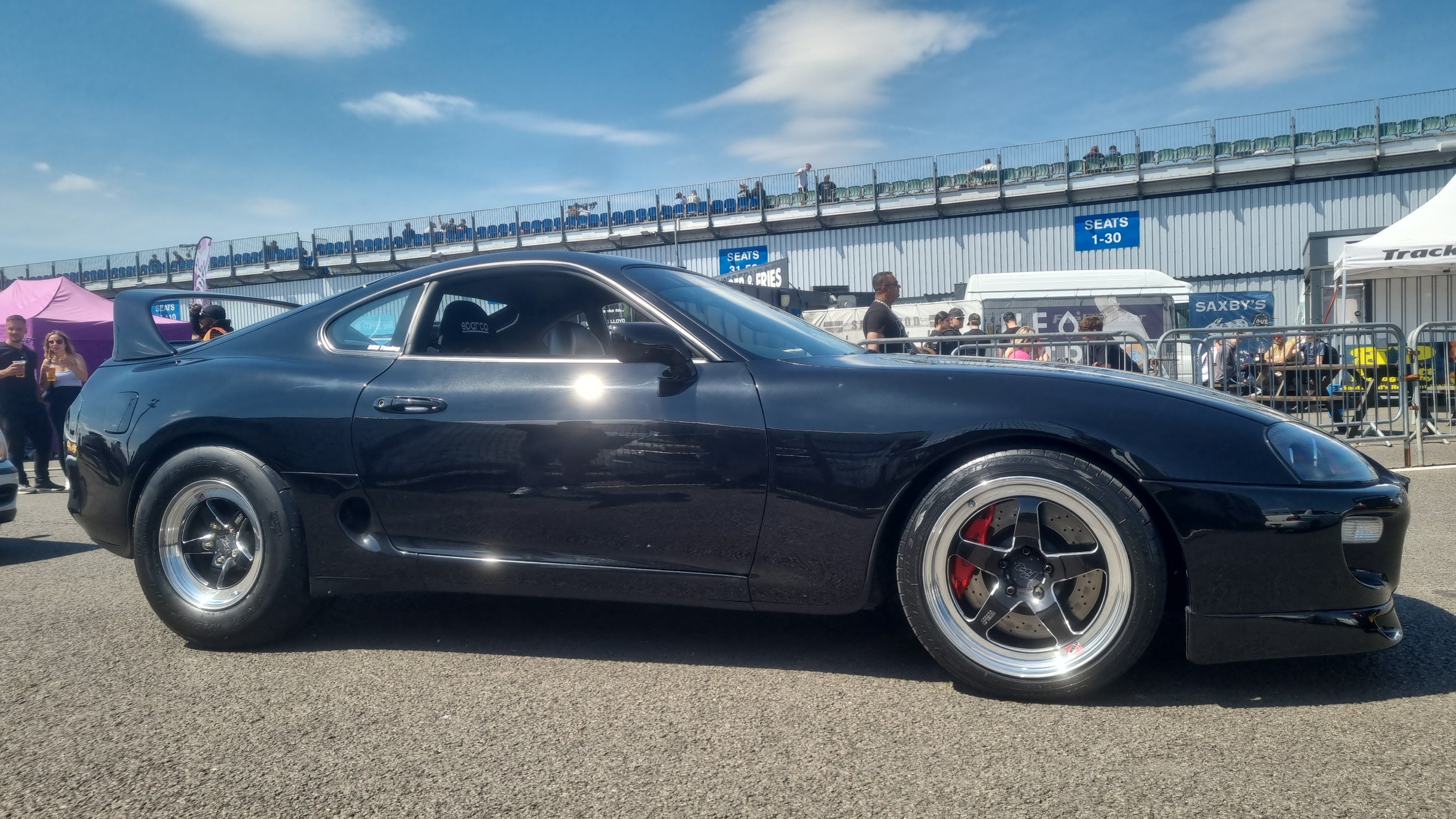

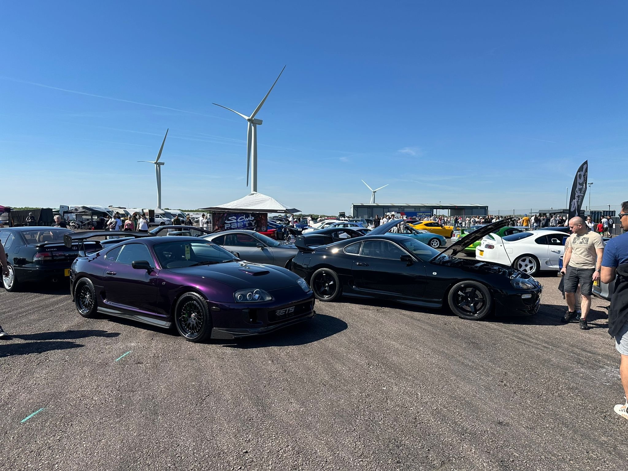

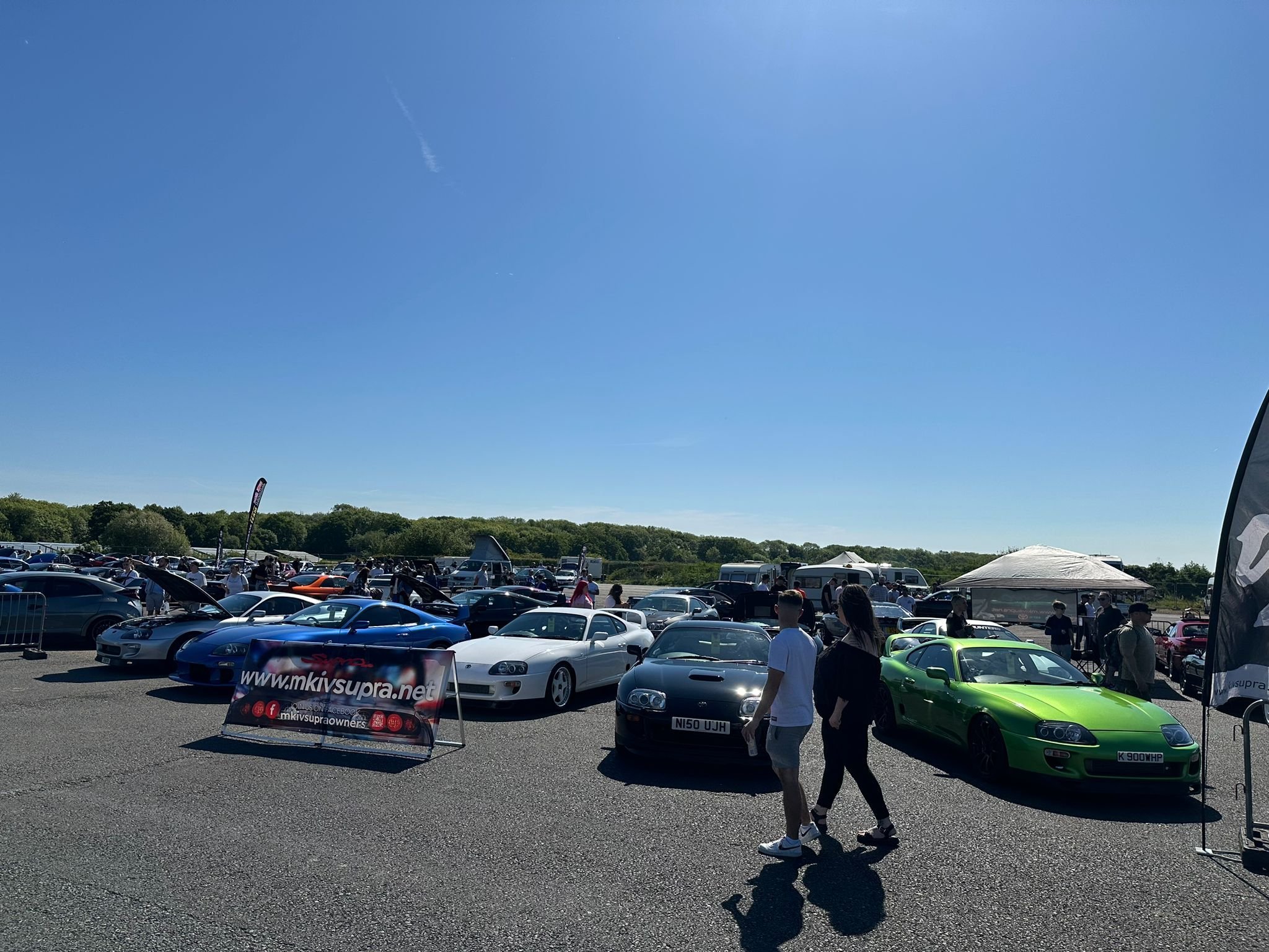

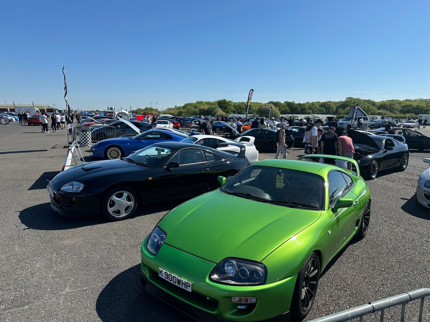

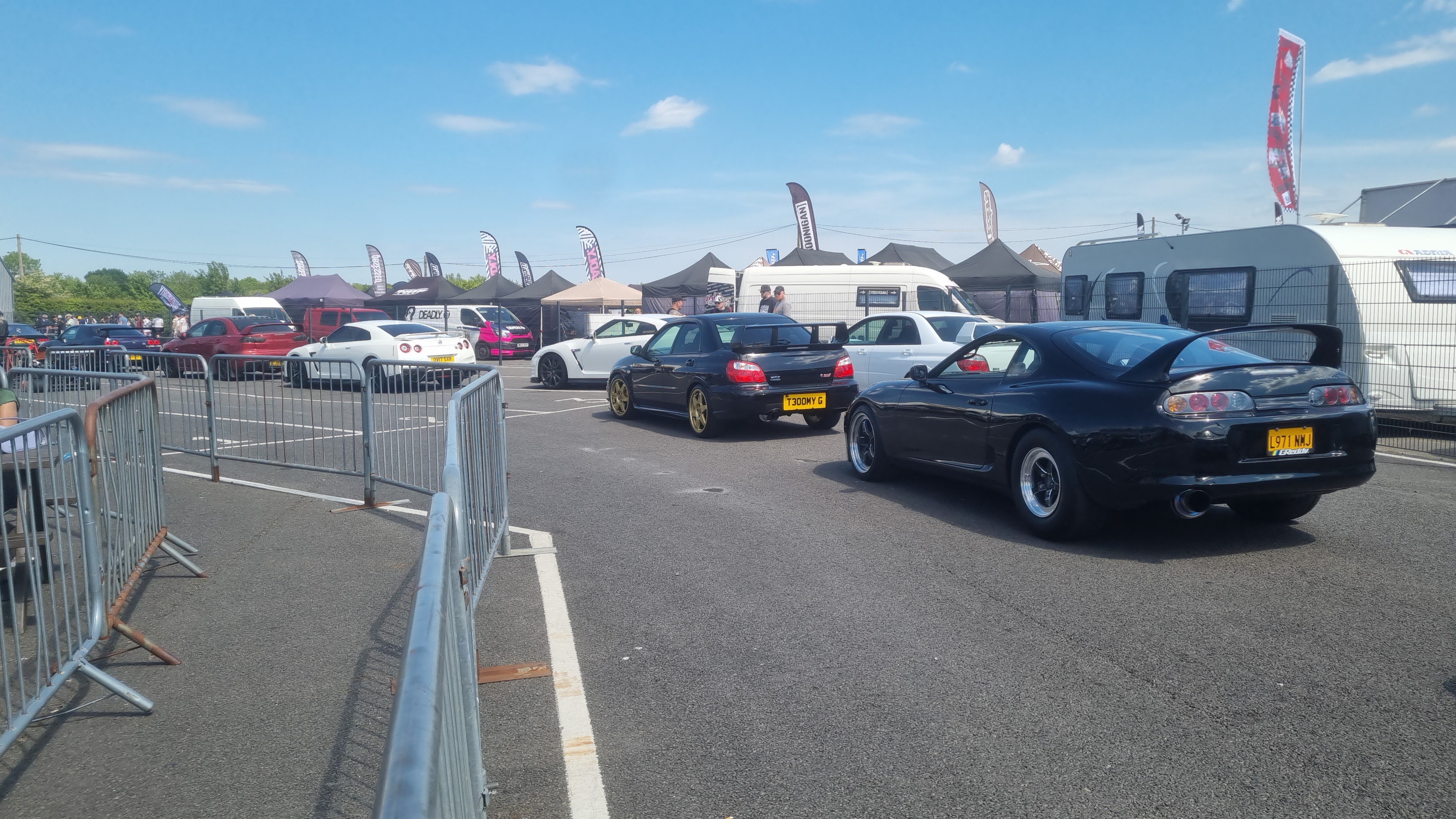

I went to Japshow with the forum crew at santa pod, had an awesome day.. mostly

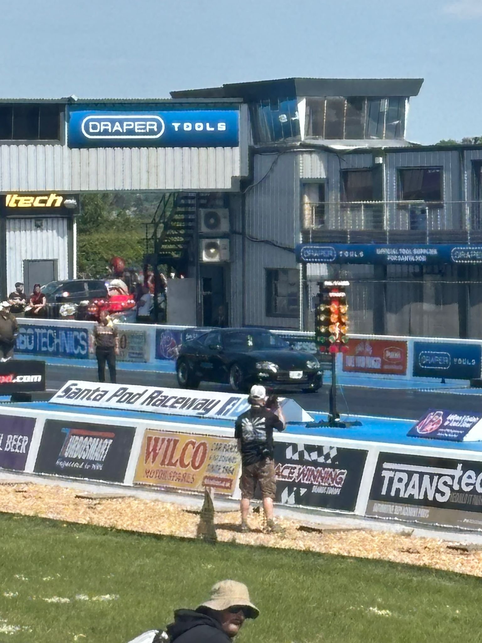

Went down the strip for the first time ever.. managed an 11.9 @ 130mph
gave it another shot and didn't give it enough off the start and bogged pretty bad.. third time round thought I'll just send it this time and gave it full launch control and dropped the clutch 😆

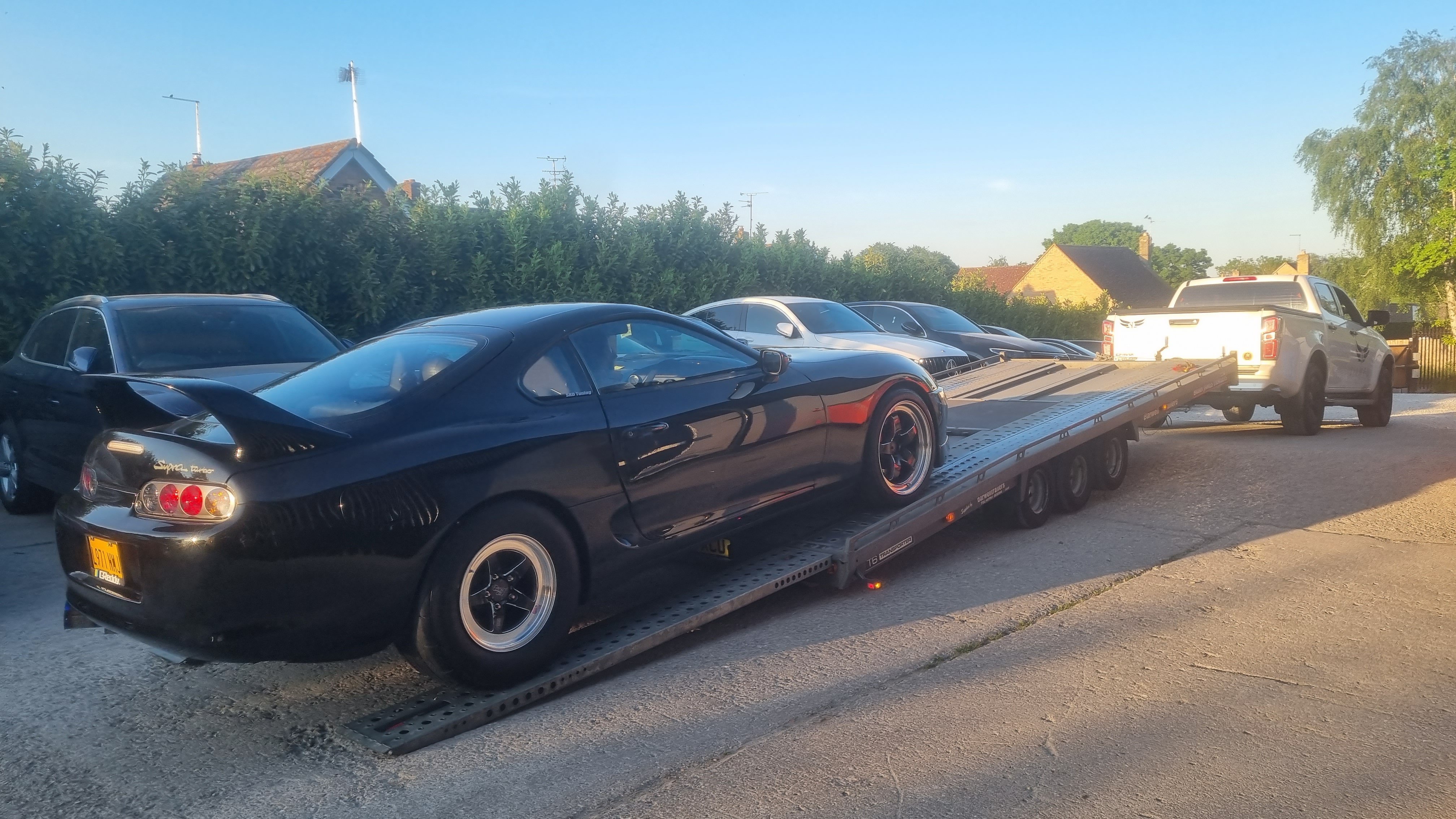

Huge bang followed by lots of rotational metal clunking and then just rolled to stop a few meters down the track.. lol
Had to call my trailer and got recovered home 🤦
we were pretty confident it was the diff and i dropped the oil that evening which confirmed our suspicions. The following day i pulled the diff out the car and removed the rear cover...
