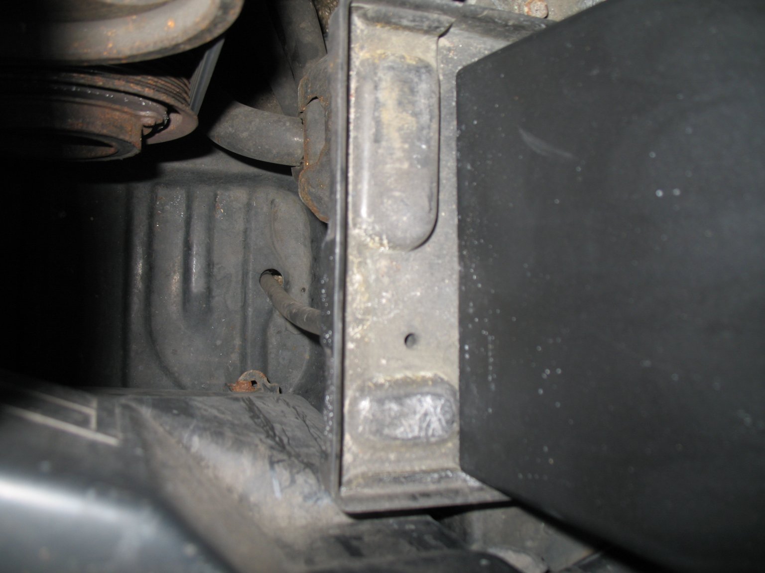

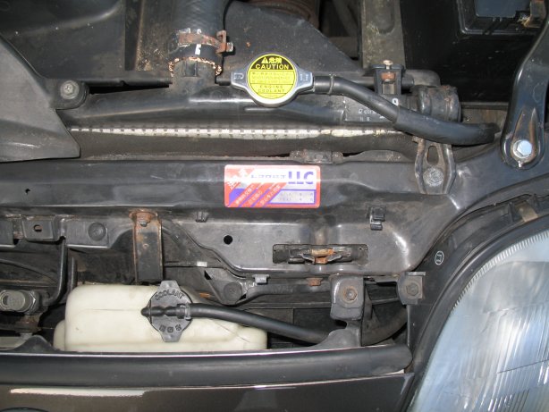

stevie_b Posted April 8, 2010 Share Posted April 8, 2010 I've had a look at my supra this evening: the pipe from the expansion tank cap goes straight to the radiator just under the rad cap. There is a drain pipe that goes through the engine undertray to the floor, but all it does is drain the battery tray of any standing water (see 2nd pic, you can see the small hole in the tray and the tube underneath). Unless I'm mistaken, the cooling system doesn't have a drain/overflow tube that dumps coolant outside the system, otherwise it wouldn't be able to hold much/any pressure. It won't do any harm to change your rad cap, but it sounds like there's something very wrong with how your coolant tubes are connected up. Even if your current rad cap isn't holding pressure, it shouldn't cause coolant to come out of anywhere other than the rad cap itself. It's just possible that this set-up is due to the aftermarket expansion bottle, but if so it's new on me. Link to comment Share on other sites More sharing options...
SteveR Posted April 8, 2010 Share Posted April 8, 2010 Unless I'm mistaken, the cooling system doesn't have a drain/overflow tube that dumps coolant outside the system, otherwise it wouldn't be able to hold much/any pressure. You're mistaken. Looking at your photos, you're missing a tube that comes off the other side of the expansion bottle cap. Coolant won't just flow away, through the expansion bottle, because the system is closed by the sprung-loaded radiator cap (assuming it's not fooked) and only opens to allow flow between the rad cap and expansion bottle (note: expansion, not a reservior like you get on most other cars) when it's fully up to temp. The overflow tube is there for if there coolant system has been overfilled, or a more serious overheating issue arises. Link to comment Share on other sites More sharing options...

SteveR Posted April 8, 2010 Share Posted April 8, 2010 stevie_b - here is apic showing the overflow pipe you're missing: Link to comment Share on other sites More sharing options...
stevie_b Posted April 9, 2010 Share Posted April 9, 2010 SteveR: thanks for the info, that's a revelation to me! . It sounds like I've got a little investigating of my own to do. There's no redundant connection on my expansion cap bottle: I've only got the tube inside the bottle itself, and the single external tube you can see in my photos going from it to the rad. Either Toyota changed the design of the system at some point, or I'm the one who has a peculiar set-up. It's never caused me problems in 4-5 years of ownership, but I like to know what's what on my cars. Link to comment Share on other sites More sharing options...
SteveR Posted April 9, 2010 Share Posted April 9, 2010 That's wierd. I wasn't aware of a type of expansion bottle without an overflow. So on yours, that nossle on the expansion bottle cap, opposite the side fitted the with the tube to the rad cap, isn't a nossle? Ju-ju. Link to comment Share on other sites More sharing options...
Swampy442 Posted April 9, 2010 Share Posted April 9, 2010 IIRC the Soarer bottle doesnt have an overflow tube, maybe a previous owner swapped it out? Link to comment Share on other sites More sharing options...
stevie_b Posted April 9, 2010 Share Posted April 9, 2010 So on yours, that nossle on the expansion bottle cap, opposite the side fitted the with the tube to the rad cap, isn't a nossle? Ju-ju. Hmm, I know what you mean. I'll have to have another look: from the pic it looks like it is a nozzle that's been plugged. From memory I don't recall seeing a plug, but that might be because I'm too used to seeing it like it is and I'm ignoring what's right under my nose. IIRC the Soarer bottle doesnt have an overflow tube, maybe a previous owner swapped it out? That's certainly a possibility. I'll take a look over the weekend. SteveR might have a point in that mine does have the 2nd nozzle, but it's been capped off with a bung. Link to comment Share on other sites More sharing options...
