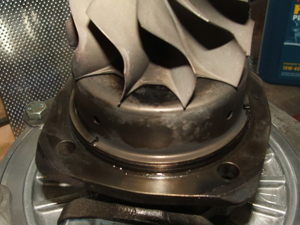

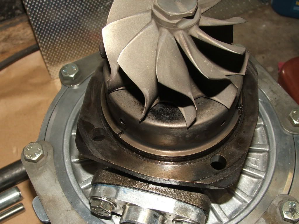

Tricky-Ricky Posted June 11, 2008 Author Share Posted June 11, 2008 OK its looking like i may have been unlucky and either bought a turbo with seal leaking, or the seal is being overwhelmed by oil pressure?? The turbo was supposed to have only done about 500mls according to Jezz who originally sold it to Migictorch (Jamie) who never fitted it, which i bought from him in good faith, as he did from Jezz, sale link here,http://www.mkivsupra.net/vbb/showthread.php?t=150056 I have now taken it off to reveal oil in the exhaust housing, and here are some pics of the exhaust turbine, and you can see a wet area , i have cleaned it a little, but it looks to me like its leaking, (only drove it for about twenty mls) So is it due to too much oil pressure, (should there be an additional restrictor??) or is my luck just shit! Link to comment Share on other sites More sharing options...

kieren1234 Posted June 11, 2008 Share Posted June 11, 2008 OK its looking like i may have been unlucky and either bought a turbo with seal leaking, or the seal is being overwhelmed by oil pressure?? The turbo was supposed to have only done about 500mls according to Jezz who originally sold it to Migictorch (Jamie) who never fitted it, which i bought from him in good faith, as he did from Jezz, sale link here,http://www.mkivsupra.net/vbb/showthread.php?t=150056 I have now taken it off to reveal oil in the exhaust housing, and here are some pics of the exhaust turbine, and you can see a wet area , i have cleaned it a little, but it looks to me like its leaking, (only drove it for about twenty mls) So is it due to too much oil pressure, (should there be an additional restrictor??) or is my luck just $#@!! http://i208.photobucket.com/albums/bb118/Tricky-Ricky13/001-2.jpg http://i208.photobucket.com/albums/bb118/Tricky-Ricky13/002-1.jpg Does not neccessarily mean the turbo seals have gone. There is definately too much oil pressure. This happened on an old turbo i had and the oil drain line wasnt getting rid of the oil quick enough, hense why the oil escaped elswhere into the exhaust housing (like mine did) and by god did it smell. Link to comment Share on other sites More sharing options...
Tricky-Ricky Posted June 11, 2008 Author Share Posted June 11, 2008 I see what your saying but i was under the impression that if the turbo had plain floating bearings like the std ones, then the oil feed was just run on system pressure, as there is no restrictor in the std turbos, and it was BB cartridge type that need the oil pressure restricting, and turbo experts care to comment?? Link to comment Share on other sites More sharing options...
Homer Posted June 11, 2008 Share Posted June 11, 2008 I see what your saying but i was under the impression that if the turbo had plain floating bearings like the std ones, then the oil feed was just run on system pressure, as there is no restrictor in the std turbos, and it was BB cartridge type that need the oil pressure restricting, and turbo experts care to comment?? Spot on, if it's pressure inside the cartridge thats causing the leak then the cartrisge is knackered anyway. The drain is gravity fed but as it's 10 times the area of the feed the oil pressure would have to be just enormous to cause a leak. Unfortunately, it looks like buggered turbo seals. It's a pretty crap turbo by all accounts, so might be best to get something a bit more beefy. Link to comment Share on other sites More sharing options...

Tricky-Ricky Posted June 12, 2008 Author Share Posted June 12, 2008 Did a bit more searching, and turned up some interesting facts regarding the use of oil restrictors on plain bearing turbos, and even Garrett recommend the use of them if oil pressure is high, I'm awaiting contact regarding my query, but the general consensus is that even a plain bearing tubos will have oil pushed past the seals if the oil pressure is to high, ideal is 30- 40 psi any more and there is a risk of either seal failure or leakage, now i have an idle pressure of 25 psi min and my pressure will go up over the 90 psi mark at high RPM, and most of the tine its around 70 psi, so I'm looking into getting the right sized restrictor, and give it a try. Link to comment Share on other sites More sharing options...
Tricky-Ricky Posted June 12, 2008 Author Share Posted June 12, 2008 OK another update, after talking to some turbo specialists, it seems that a restrictor should in most cases not be used, however, it seems if the seal is not screwed (need to have that checked before verdict) it could be that high oil pressure coupled with low back pressure in the exhaust could combine to help the seal to leak a bit! confused? i am. So do i risk making a smaller restriction in the oil way and run the risk of screwing the bearings as well, or just bite the bullet and send the dam thing off to be checked, and max the credit card some more:( Anyway here is another interesting fact to add to the failing GT4088 mystery, the material that the exhaust turbine is made of is no different to all the other petrol use turbos, and the only explanation that i could glean for the destruction of the exhaust turbines that have been experienced is that the housing material is different and could distort and go oval thereby wearing the blades, but that doesn't explain the eroded look of the ones that have been shown. Link to comment Share on other sites More sharing options...
