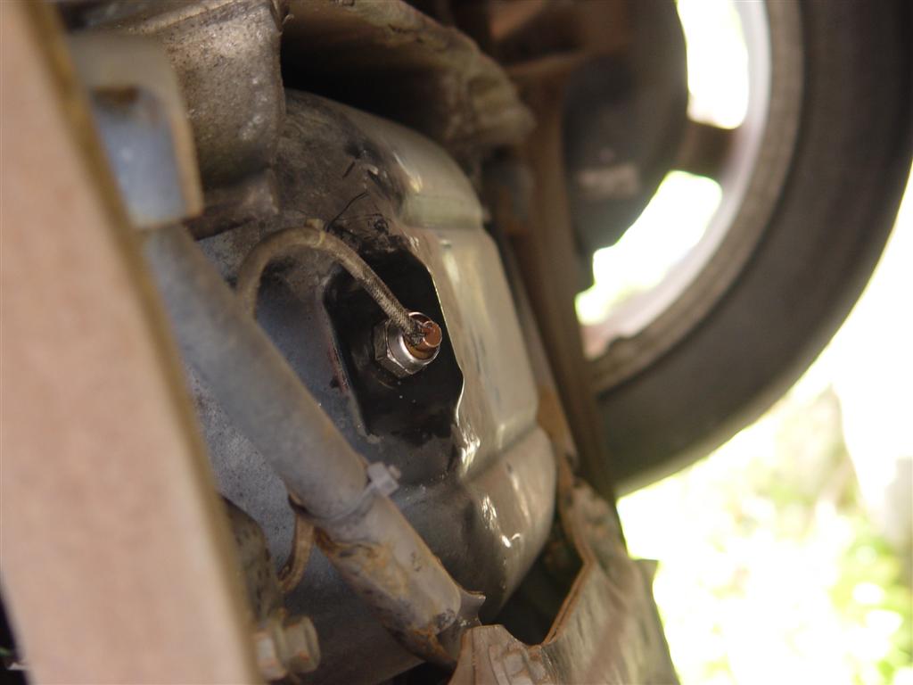

Guru Posted June 11, 2006 Author Share Posted June 11, 2006 Ok now I am really doubting myself lol....this is what I am undoing thinking its the sump bolt! God I wish I wasn't so lame with mechanical bits! Link to comment Share on other sites More sharing options...
uk-rich Posted June 11, 2006 Share Posted June 11, 2006 edited ! not sure thats a really bad angle Link to comment Share on other sites More sharing options...
Guru Posted June 11, 2006 Author Share Posted June 11, 2006 thats not the sump bolt Arrrrggggghhhhh! I had assumed it was from a tutorial I read somewhere! Link to comment Share on other sites More sharing options...

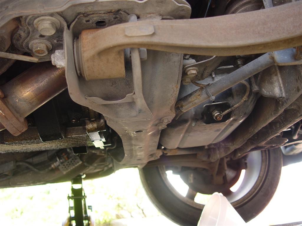

Guru Posted June 11, 2006 Author Share Posted June 11, 2006 edited ! not sure that a really bad angle Doh! Ok gimme 2 secs for another shot.... Link to comment Share on other sites More sharing options...
Guru Posted June 11, 2006 Author Share Posted June 11, 2006 On the right is the bolt I am looking at... Link to comment Share on other sites More sharing options...
uk-rich Posted June 11, 2006 Share Posted June 11, 2006 thats the one fella, much better angle ! Link to comment Share on other sites More sharing options...
Guru Posted June 11, 2006 Author Share Posted June 11, 2006 Ok so it is the sump then......damn that sucker is on strong though......and its not a 14mm spanner size like other posts say...... Link to comment Share on other sites More sharing options...
uk-rich Posted June 11, 2006 Share Posted June 11, 2006 14mm is the size for the standard plug, is there not a connector you can undo and get a ring spanner on it Link to comment Share on other sites More sharing options...
Guru Posted June 11, 2006 Author Share Posted June 11, 2006 Got it! I used a slightly bigger spanner....19mm I think...and a load of WD40 and it gave in muhahaha! Thanks to all that helped Link to comment Share on other sites More sharing options...
