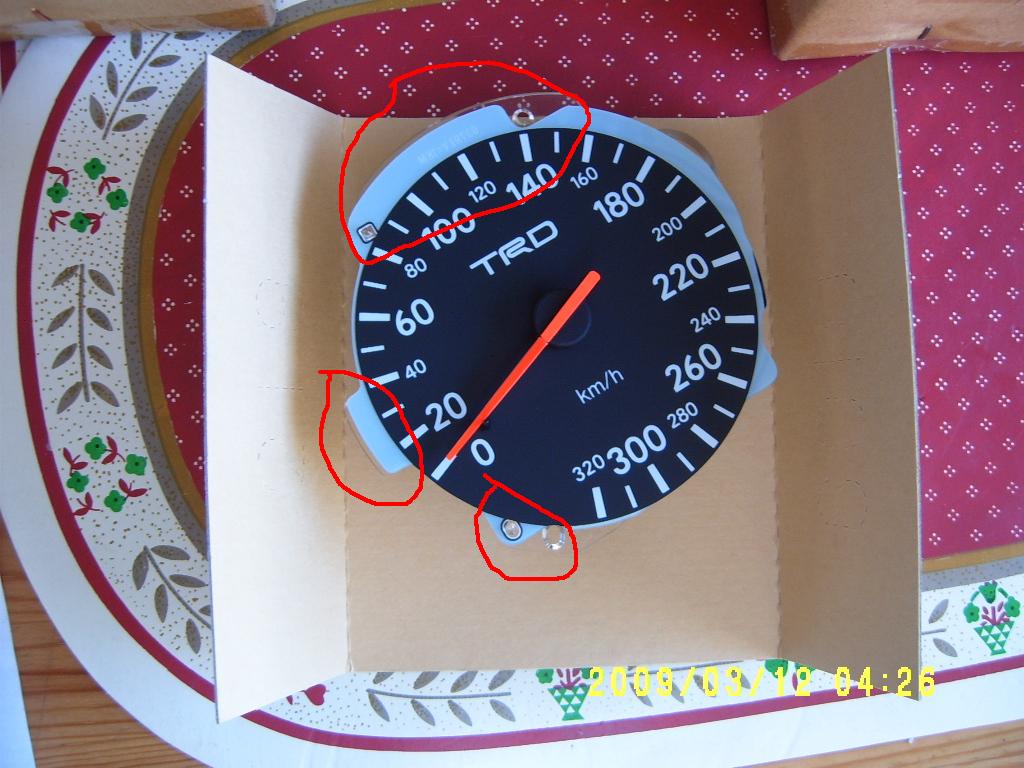

Nic Posted February 24, 2006 Share Posted February 24, 2006 Doe anyone know if a speedo from a RHD Supra will fit/work on a LHD car? I have a European customer who wants to buy/fit a TRD 320kmh Speedo on his European Supra but I cannot find out any information about whether they are compatible. Any help would be appreciated. Link to comment Share on other sites More sharing options...
TLicense Posted February 24, 2006 Share Posted February 24, 2006 I beleive they are the same, as a few people have them. Link to comment Share on other sites More sharing options...
DamanC Posted February 25, 2006 Share Posted February 25, 2006 Speedo and rev counter yes, water temp and fuel no Link to comment Share on other sites More sharing options...
adi2009 Posted February 25, 2006 Share Posted February 25, 2006 I m not too sure about that cuz I remember i was hunting for a rev counter and Curt Aiger told me that the mounting points on the rev counter is different between teh LHD and RHD cars. So possibly the mountings are different for the speedometer as well. Link to comment Share on other sites More sharing options...
c0c4in3 Posted February 25, 2006 Share Posted February 25, 2006 Yes, that's no Problem. You can fit the 10K and 320 KMH Speedo without any problem. Link to comment Share on other sites More sharing options...

Ulrik Posted February 26, 2006 Share Posted February 26, 2006 They do fit, if you remove the "meter" from the new TRD 320km/h and put it over your old one... Because it dosent fit right in... But the TRD 10k Meter fits 100% in....easy to do. See my pictures from home here... P.M if more pics are needed or need any info... Link to comment Share on other sites More sharing options...
Kite Posted February 27, 2006 Share Posted February 27, 2006 They do fit, if you remove the "meter" from the new TRD 320km/h and put it over your old one... Because it dosent fit right in... But the TRD 10k Meter fits 100% in....easy to do. See my pictures from home here... P.M if more pics are needed or need any info... Are you saying you can move the meter but not the dial? So you have a meter that works until 320km/h but the dial shows only until 300? Link to comment Share on other sites More sharing options...
Ulrik Posted February 27, 2006 Share Posted February 27, 2006 Are you saying you can move the meter but not the dial? So you have a meter that works until 320km/h but the dial shows only until 300? Good Question... The only part i know so far is that you can remove the TRD 320km/h from its original holder....and put just the 320 card over your old one.. Thats what they said in sweden at www.supramannen.com So i guess it shows 320....But there is no "neddle" to stop it from going higher then the 300.... Hmm i might have to look this up some more befor i install my 320.... Link to comment Share on other sites More sharing options...

Ulrik Posted March 7, 2006 Share Posted March 7, 2006 Okey just talked to some folks at the swedish forum.... Its only for show, the 320km/h are fited over the original 300 km/h. BUT how ever the "needle" can go over that 300 km/h... So no need to worrie.... It would be just like fiting the 320km/h on the RHD car... Exept its alot more work to make it fit the LHD... Ill snap some pics when im done with mine Link to comment Share on other sites More sharing options...

Kite Posted October 6, 2006 Share Posted October 6, 2006 Finally got it installed. It needed some DIY to get it to work but now it works like a charm. Link to comment Share on other sites More sharing options...
