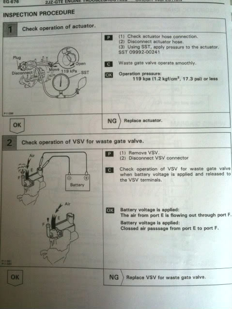

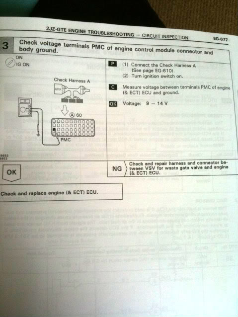

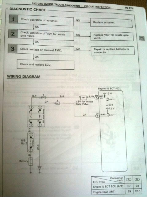

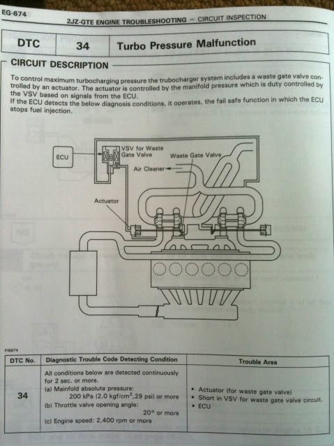

Hmmmm, my manual says all what i said in post 2. Are you useing CJ's manual?
That was from the FAQ, let me go check my CJ Manual i have......
EDIT: Yes, my CJ manual is identical to that link i posted. So code 34 is Turbo pressure malfunction.
Edited by Steve (see edit history)
NUTS!! I must have a misprint then??Oh well....at least I wont be cold this winter.....

Sounds like you've hit fuel cut / boost cut. Have you been running above 1 bar boost?
Yes my HKS evc5 is set to 1.15bar, although I am also running a fcd, this is the 1st time this has happened and the car has been running like this for at least 3 years :)
