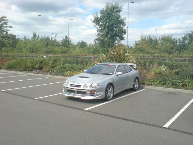

hadyn Posted August 1, 2008 Share Posted August 1, 2008 Also, the supposedly 'ceramic coated' pistons in the ST205 are more prone to detonation that the previous two generations. I have to question why you say that when you can safely run 1.2 bar (fuel cut on st205s is over 1.2bar) boost on ST205s with stock fuelling. AFAIK previous GT4s could only run around about 1bar safely on stock fuelling. Is this down to the efficient charge cooling system on the ST205? In my laymans terms, I consider the ST205 engine to be the one i'd have for its generalstrenght in stock trim form. There seems to be many problems with 1980s toyota turbo engines which were rectified with their 1990s line of engines I'd quite like an 165 with a charge cooled ST205 3SGTE shoe-horned in Heres a pic of my mate's ST205: He's just had it decatted, has a blitz nur spec, panel filter and boost at 1.1 bar with a mbc and we suspect its running about 300bhp. Certainly feels like it and is a hoot to drive Link to comment Share on other sites More sharing options...
ADL Mark Posted August 1, 2008 Share Posted August 1, 2008 Not sure I explained that quite right, the ECU is capable of running more boost and fuelling it correctly, yes. But that has nothing to do with the pistons. However, when det does happen, the ST205 pistons are less well equipped to stand up to it than the other generations. IMO, the ST165 was the best to drive, I've had all three now and my girlfriend currently has a near-stock UK ST205, but the ST165 was much more fun and engaging. I've driven a couple of ST185's and they are by far my least favourite. Link to comment Share on other sites More sharing options...
hadyn Posted August 1, 2008 Share Posted August 1, 2008 Good job det doesnt happen with ST205s then as long as the boost is below 1.2 bar Link to comment Share on other sites More sharing options...
