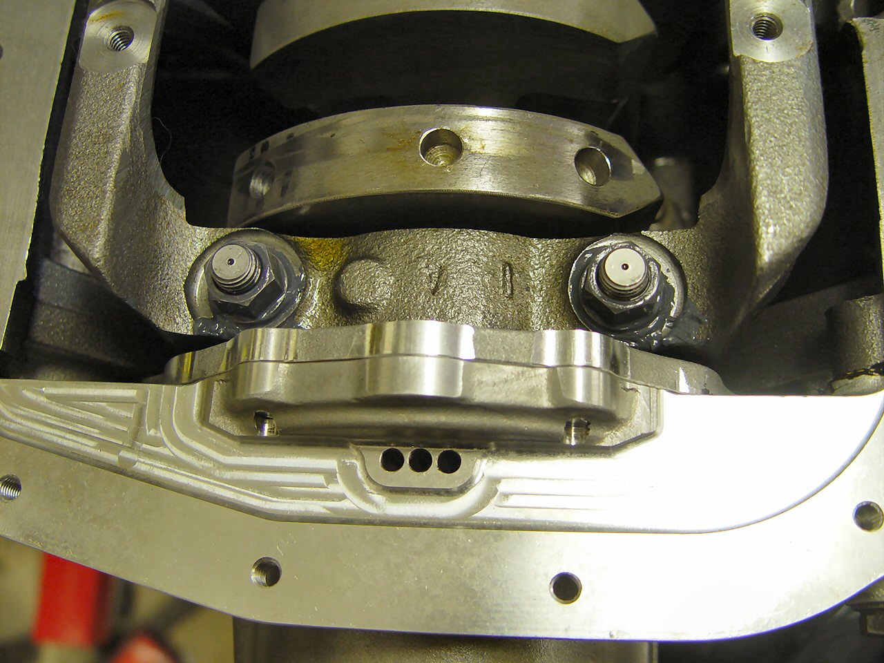

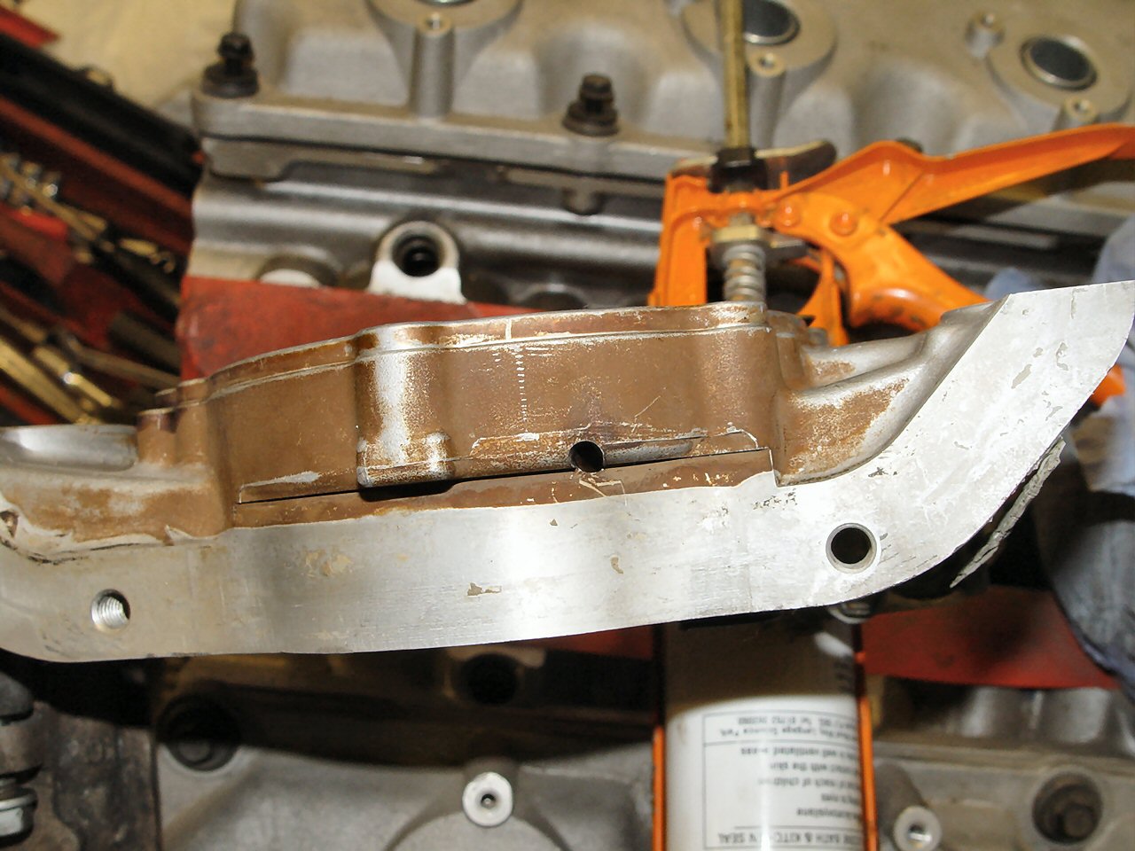

Chris Wilson Posted October 3, 2007 Author Share Posted October 3, 2007 Just realised, note we have a good photo of how much bigger Nissan made the oil pump rotor leakage drain on the (stock) Skyline pump, compared to the tiddly thing on a Supra *JZ-GT* pump? The second pic shows how the aftermarket Tomei race pump has even bigger leakage drain area Link to comment Share on other sites More sharing options...
