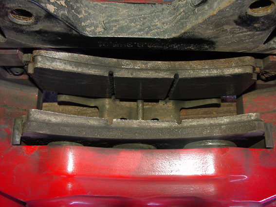

BUT the pads do have uneven wear.. intake side of the pad is 5mm thick, exit side of the pad is 7-8mm - it's a long pad, photo enclosed. I have asked Rotora and they volunteer no information as to whey the pads wear unevenly or if they could cause any problems...
edit, yes the pedal travel is long, until I pump and then the pedal travel is smaller, hence why rotora suggested - pad knock...?
What pad compound? How much longitudinal end float between pads and caliper end stops? Car usage? Do they pull only when hot, or only cold, or both? Fixed or floating discs?
Some taper wear is normal, you'd have to *ugger about with compounds and cooling and be SURE to have optimised piston differential sizing to stop all taper. Pulling is NOT normal though. Again, what's the pedal like? Soft or hard, long stroke or right up near the top? Have you got a helper there?

OK, a brief stab at a few ideas. You basically don't know the compound, which suggests generic pads from the caliper supplier. Treat it to some decent pads, which, IMO, means choose between Performance Friction and Endless, *IF* they list these pads. I hope the makers haven't used an "odd" pad shape forcing you to buy only from themselves?
Get your helper away from the TV, use bribery or force, as you feel inclined ;) Jack the front up safely, and remove both front wheels. Put 3 wheel nuts on the studs and tighten firmly against the disc bells, on both sides of the car. Use washers if the studs bottom out in the nuts before the bells are held firm. Get her to press the pedal firmly a couple of times, but not more often, you don't want to drain the vacuum from the servo. If this may be a problem do the test with the engine idling *IN PARK* or neutral, handbrake hard on. Once the pads are settled get her to press the brake pedal HARD whilst you VERY CAREFULLY look for flex in the caliper mountings or disc and bell. With the engine running you can do this a multitude of times without losing the servo assist. Without servo assist you may well not see the flex, if it exists. You are looking so see if the caliper is not mounted absolutely parallel to the disc surfaces, in both planes, and as the pistons force the pads against the disc this inaccuracy is shown by the caliper shifting to align itself with the disc faces, or indeed, the disc or bell itself flexing. There should be NO caliper or bracketry movement, or disc, AT ALL. If there is you need to address the misalignmnt. Even a barely notecable flex will give a long pedal and odd wear or pulling. I suspct one side will have misalignment, and it will be the side opposite that to which the car pulls. Whatever, you can generally say that the problem will be the side OPPOSITE that to which the car pulls. If you a dial gauge check for disc run out with the bells bolted up as above. More than 3 thou inch is poor, more than 10 thou and it needs sorting as that is bad.
Fitting new pads will make a big difference, once taper wear starts it self propogates, and the geometry of the piston to pad backing plates is severely compromised. Don't panic if you find no flex, you may be lucky and find parallel faced new pads will be the panacea you need. Spend more than you think is modest on good pads, like good tyres they will transform your driving pleasure, and be cheaper, long term. Avoid Performance Friction Z rated pads, they are made to be a zero noise pad for the ultra noise intolerant US market, get a race pad like 03 compound. They work fine from cold and are very disc friendly with low disc wear. This is important as the discs are bound to be made of recycled junk ;) Treat it to matching compound pads on the rear :) Hope that helps. If it was here I'd fix it, assuming that the calipers themselves are not so *rap as to be the cause of the trouble in themslves, but as you say they were OK on another car this shouldn't be the issue.

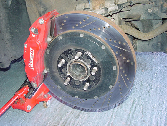

Update;
stripped the fronts as Chris suggested, bolted the bells in place, ran the car, found helper and checked for caliper/disk movement.
Driver's side; showed no movement on hard brake application; this was the driver's side, the disk also ran true and straight through the caliper with no discernable warp whatsoever.
Passenger's side; here there was movement, not so much to the eye, but when you put your fingers so they touch the disk and caliper a the same time you can feel the disk move on application. It's as if the caliper is trying to twist the disk on hard application.
Also the disk was not perfectly straight - there was a definate free running section of disk and a section that catches the pads.. a slight warp. When braking I feel no warp at all.....
So this kind of fits; the passenger side is not braking as hard as the drivers side causing the car to have a tendancy to creep right. and there is a lot of pad knock; on such big disks this could explain it... right?
So... I'm tapping Jurgen up to get the caliper aligned (have him check both I would think).. and shall I get the passenger disk skimmed? or both skimmed.. there is plenty of meat on them and just a very very slight warp of the passenger side... as well as some new pads; I was thinking H6, but these look like they are only goingto start working at 200 degrees c..?

BIG thanks go to sir Chris who seems to have been dead on with this diagnosis!
What make of pads are these? What make of discs? If a big vented disc takes a warp they rarely grind and stay true. I'd replace them with AP or Alcon ones, *IF* they are available to fit your bells.
Before anything else try releasing the caliper bracket and caliper bolts a turn or so, get someone to press the brake hard, and re torque them. With a lot of luck they may re align and stay re aligned, worth a quick go?,

UPDATE;
Many Thanks to CHRIS WILSON,
instructions followed to the letter and problem 100% cured; you were bang on!
pedal feel is much imporoved, brake balance perfect.
Sir, you are a star, a credit to the club.
for all those that have aftermarket brakes, check the alignment when you put them on.. it makes perfect sense and a massive difference. :D
