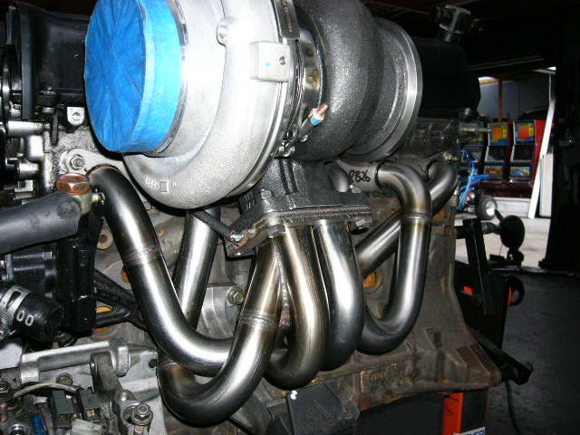

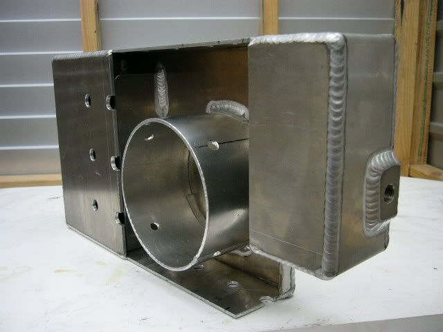

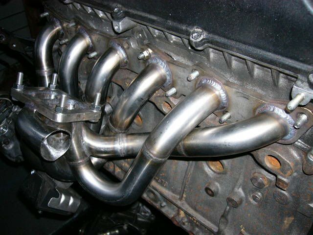

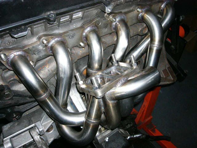

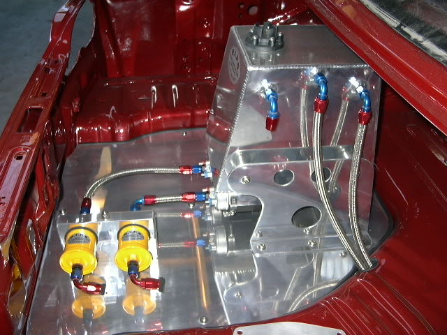

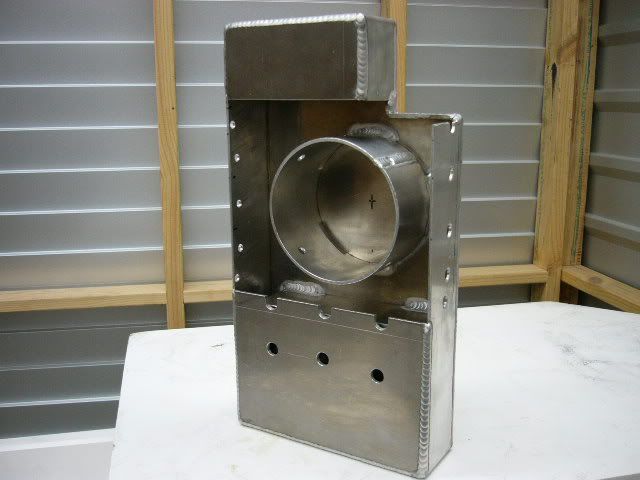

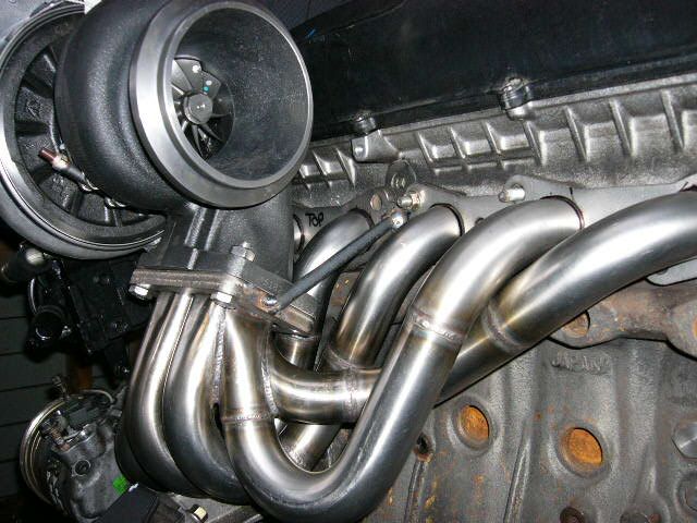

MONKEYmark Posted August 26, 2004 Author Share Posted August 26, 2004 heres a few pics of some of his work, he prefers to make custom parts. he is more a skyline nut who does his own tuning. he has ran a 10.2 with a home brew skyline gts4 with an old turbo and nos. i have asked him about doing a fuel kit too. the pic is of a swirl pot system. stock pump feeding the swirl pot and 2 external pumps for fuel lines. http://img.photobucket.com/albums/v163/MONKEYmark/robs-welding/StainlessexhaustmanifoldRB30with26head002.jpg http://img.photobucket.com/albums/v163/MONKEYmark/robs-welding/StainlessexhaustmanifoldRB30with26head001.jpg http://img.photobucket.com/albums/v163/MONKEYmark/robs-welding/RIPSGTRalloysumpinternals002.jpg http://img.photobucket.com/albums/v163/MONKEYmark/robs-welding/RIPSGTRalloysumpinternals001.jpg http://img.photobucket.com/albums/v163/MONKEYmark/robs-welding/GT42ExhaustManifold002.jpg http://img.photobucket.com/albums/v163/MONKEYmark/robs-welding/GT42ExhaustManifold001.jpg Link to comment Share on other sites More sharing options...
dangerous brain Posted August 26, 2004 Share Posted August 26, 2004 Originally posted by eyefi there's no other way in. it does'nt take long. alternatively get a full flush done. Erm whats wrong with the fill point on the top of the gearbox??? Well apart from being a total sod to get anywhere near. How do you go about a flush? And ref that big picture what the hell is that contraption?? Looks like an early edition dalek:( Workmanship looks great though. Link to comment Share on other sites More sharing options...
