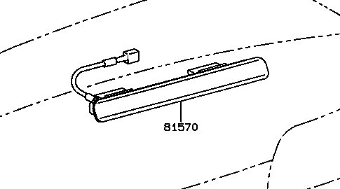

Steve W Posted August 16, 2003 Share Posted August 16, 2003 Nothing found so far matie....sorry... (nothing in Owners Handbook, just 'normal' bulb replacement, doesn't even MENTION the H'L'LED ! ! ! - don't think they're 'meant' to go wrong - but they DO ! !) only pic so far > > > (EPC disc) Link to comment Share on other sites More sharing options...
