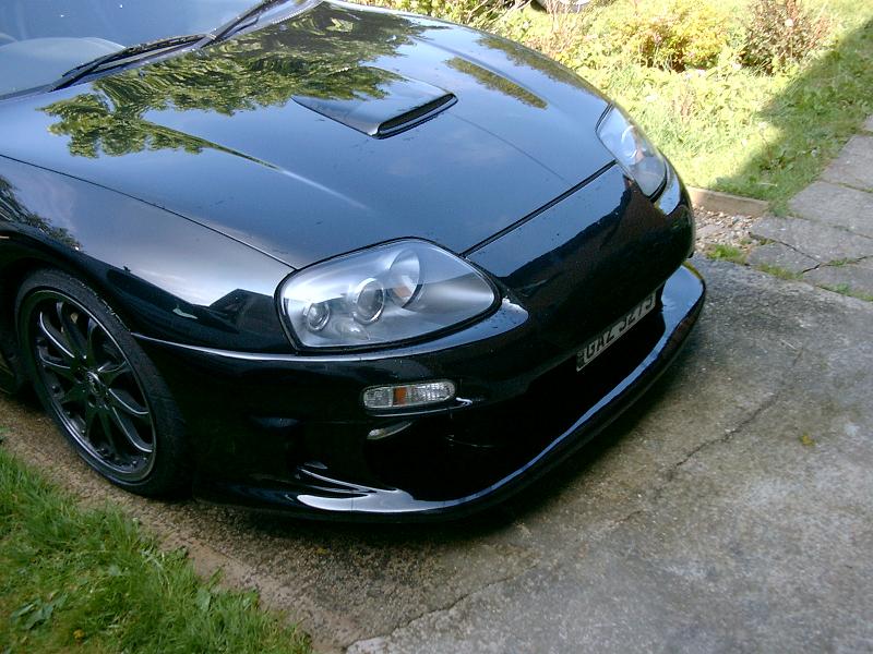

JamesC Posted December 23, 2007 Share Posted December 23, 2007 I gave mine a quick wet and dry, primer then satin black, didn't bother with the laquer, i think the shiney finish wouldn't have looked right on my Black car. I also used some meguires plastx on the inside and outside of the lense to get rid of any yellowness. I think that masking the rings to leave them chrome makes loads of difference and well worth the time. There wasn't enough sealent left on mine so went to Halfords and got a small tube of black windscreen sealent (i think) which did the job, hasn't misted up yet! My effort: (alhough its hard to see because of the reflections) Quote Link to comment Share on other sites More sharing options...

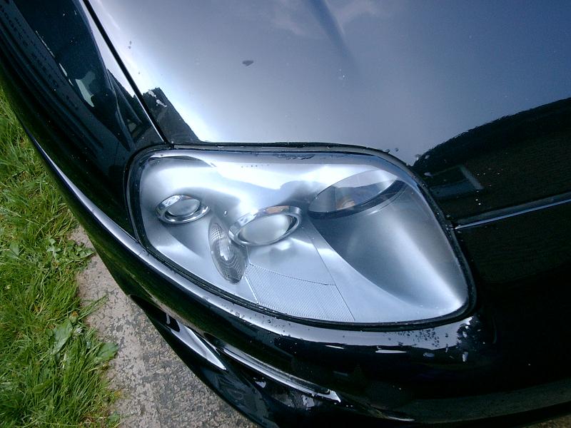

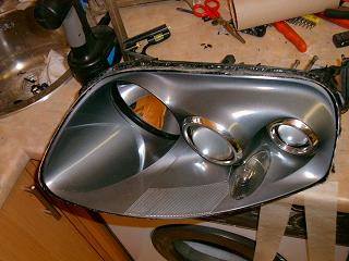

suprattgaz Posted December 23, 2007 Share Posted December 23, 2007 My efforts - used a metallic graphite heat resistant paint. Quote Link to comment Share on other sites More sharing options...
