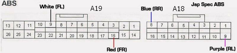

As for fitting. . it went ok :) I had no problems with the wiring at all apart from the lack of play on the wiring looms (is a slight pain) and the lack of space (removing the glove box gives a little extra room) and your arm will probably ache a little but it saves a bit of money at the end of the day :) When you unplug the ABS plug from the little ABS ECU (under the stereo) it helped me alot to pull the wiring loom through into the driver footwell to do the connections instead of struggeling in the dash space :) I would also say start it in the morning because it took me about 4-5hours to fit the unit on saturday and then a couple of hours fiddling with the dat file today. I made myself a little table to help me with the installation I'l try and post it up. What car do you have (TT - N/A auto - manual)? If you have TT auto then my little table may be of use
