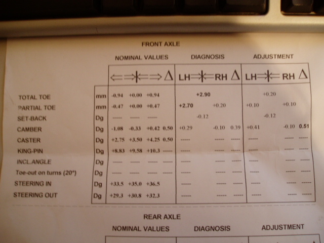

toyotasuprauk Posted November 29, 2004 Share Posted November 29, 2004 About a month ago I had a 4 wheel alignment done. The back tyres are fine but the fronts have worn heavily on the inside edge, especially the right wheel. I'm concerned the jobs not been done correctly. Does anyone have any comments on these results? Front Axle: Link to comment Share on other sites More sharing options...

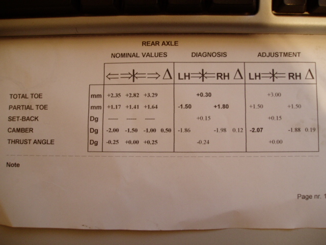

toyotasuprauk Posted November 29, 2004 Author Share Posted November 29, 2004 Rear Axle: Link to comment Share on other sites More sharing options...
