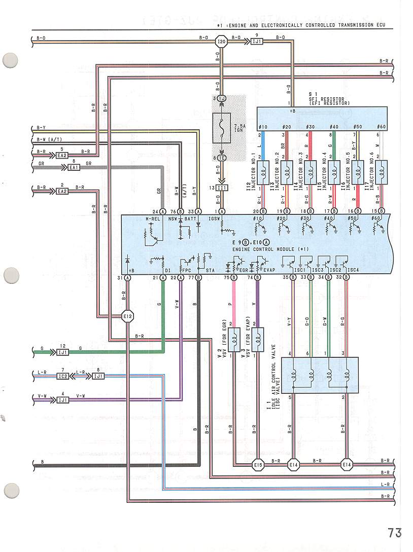

Robbie Posted January 10, 2007 Share Posted January 10, 2007 I want/need to get my IAC valve on the intake plenum working on my V-pro for the cold start. In order to do so I need to trace the link back to the ecu. I then need to rewire it directly to the v-pro. Does anyone know the wires. Mine is a UK spec auto ecu. Thanks Link to comment Share on other sites More sharing options...
bondango Posted January 10, 2007 Share Posted January 10, 2007 I want/need to get my IAC valve on the intake plenum working on my V-pro for the cold start. In order to do so I need to trace the link back to the ecu. I then need to rewire it directly to the v-pro. Does anyone know the wires. Mine is a UK spec auto ecu. Thanks http://www.mkivsupra.net/vbb/attachment.php?attachmentid=13919&d=1112558155 Pins 32 to 35 Link to comment Share on other sites More sharing options...
Robbie Posted January 10, 2007 Author Share Posted January 10, 2007 This might sound a silly question but are these 4 pins all for the one on the plenum? Link to comment Share on other sites More sharing options...
bondango Posted January 10, 2007 Share Posted January 10, 2007 This might sound a silly question but are these 4 pins all for the one on the plenum? Yup, colour coding may be different but heres the schematic Link to comment Share on other sites More sharing options...
Robbie Posted January 10, 2007 Author Share Posted January 10, 2007 You have my thanks. Link to comment Share on other sites More sharing options...
