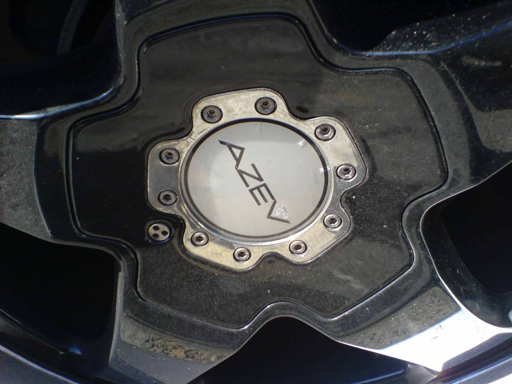

Lee GZ Posted July 12, 2006 Author Share Posted July 12, 2006 Cheers Rob, I have already told Toyota to order me some, its a bit of a pain because i didn’t fit them my self paid some chap at a garage £30 cash to quickly shove them on..! Another problem i have now is i got my sup serviced 3 to 4 weeks ago also and i think the bloke i got to do it has lost the facia plate key for my wheels..! I can get them off but it’s just a pain to do, anyone know where i could lay my hands on a replacement ..? Link to comment Share on other sites More sharing options...
