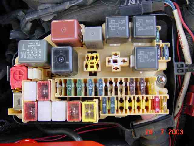

I had to reset my ECU today after i HAD to use normal unleaded to get home from Billing or i would have run out of petrol!!! I allways use Optimax.
Looking in the fuse box i noticed my ABS fuse's wern't there, also my fan fuse, and 1 of my EFI fuse's. Is this ok or have i missread the diagram? Theres a space at the 30a fuse's at the top, and looking at the diagram it looks like theres a fuse in the second EFI slot, and then below in the AMI (i think) slot.
Any help would be great. The car runs perfect, shall i just put some fuses in???
Hope that makes sense
Paul

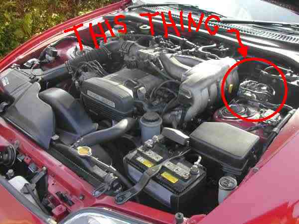

Possibly the safest way to find out you don't have ABS there, much safer then the way I found out anyway.
Not to sure about the SZ-R, but my SZ doesn't have ABS, and only has the one EFI fuse.
A bit like this...
If you have ABS, you should have a big lump of metal near the brake cylinder with lots of brake pipes going in and out. If you've just got the cylinder, reservoir and servo, then you're on your own in the emergency brake.
Originally posted by Paul Laing
no i havn't got what was circled on the pic, does this mean no ABS???
Paul
I'm afraid not. Bet you don't brake so hard from now on.
