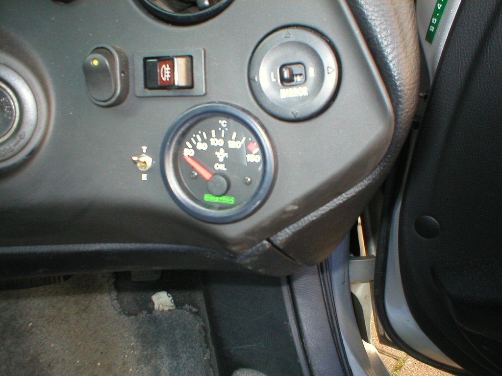

paul mac Posted February 18, 2006 Share Posted February 18, 2006 pic of tee for temp sender, it is just a 1/2" black iron tee with 1/2" BSP to 12mm hose tails cost about £1, i chose to use a relativly large size so as not to impede flow and was carefull to check where the sender ended up inside the tee with a bit of filing of the 1/2" BSP to 1/8" fitting to get it spot on, second pic is the gauge i used these are the cheap single wire senders not thermocouples so i ran it through a 2 pole switch (not possible with thermocouples) with the engine sump oil temp as i've run out of places for gauges Link to comment Share on other sites More sharing options...
