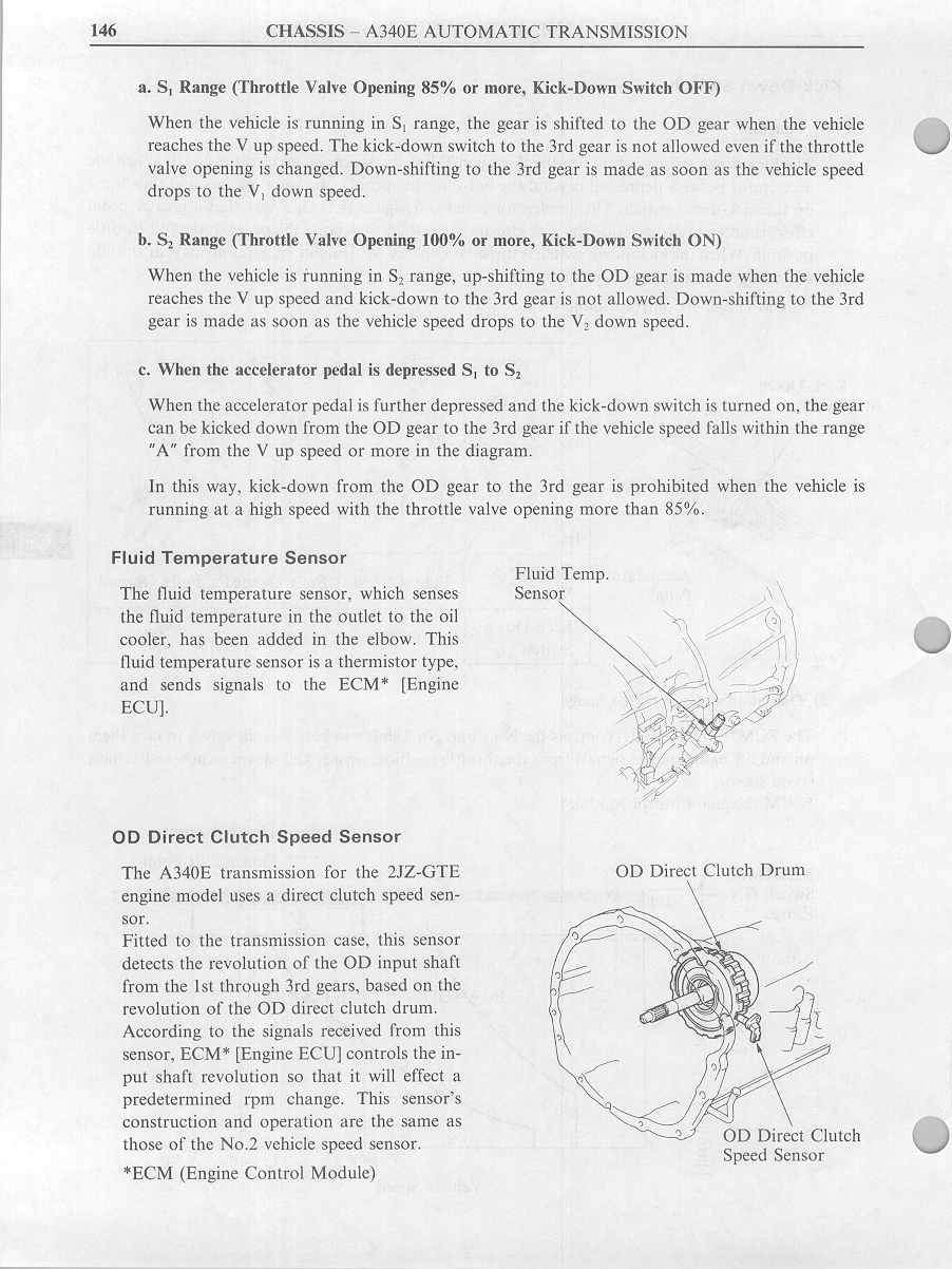

Robert Posted September 4, 2005 Share Posted September 4, 2005 ok well my O/D light has been flashing and i checked for codes and its a code 38 which means 'open or short in fluid temperature sensor', where is the sensor located and how easy is it to replace? Link to comment Share on other sites More sharing options...

Jake Posted September 5, 2005 Share Posted September 5, 2005 There's a few sensors in the gearbox. They can all be seen from under the car and are on the side of the box, between the box and the transmission tunnel. IIRC there are four seperate electrical connectors, all but one are on the passenger side. I would start by checking the integrity of each connection. They do get covered in a lot of grime. 10mins with some WD40 might save replacing a sensor. Link to comment Share on other sites More sharing options...

jamesgtr Posted September 5, 2005 Share Posted September 5, 2005 Robert, Looking at the epc pic, looks like the sensor sits on top of the gearbox. Part no. 89429-30010. Rear shocks ordered for Wed. Link to comment Share on other sites More sharing options...
Jake Posted September 5, 2005 Share Posted September 5, 2005 Robert, Looking at the epc pic, looks like the sensor sits on top of the gearbox. Part no. 89429-30010. Rear shocks ordered for Wed. On the top? Any chance you could post the EPC picture please James? Link to comment Share on other sites More sharing options...
Robert Posted September 5, 2005 Author Share Posted September 5, 2005 heres a pic of it Link to comment Share on other sites More sharing options...
jamesgtr Posted September 5, 2005 Share Posted September 5, 2005 There you go. Robert's done it. And he's proved me wrong. Honestly, looking at the epc pic, it does look like it sits on top. Sorry guys. Link to comment Share on other sites More sharing options...
