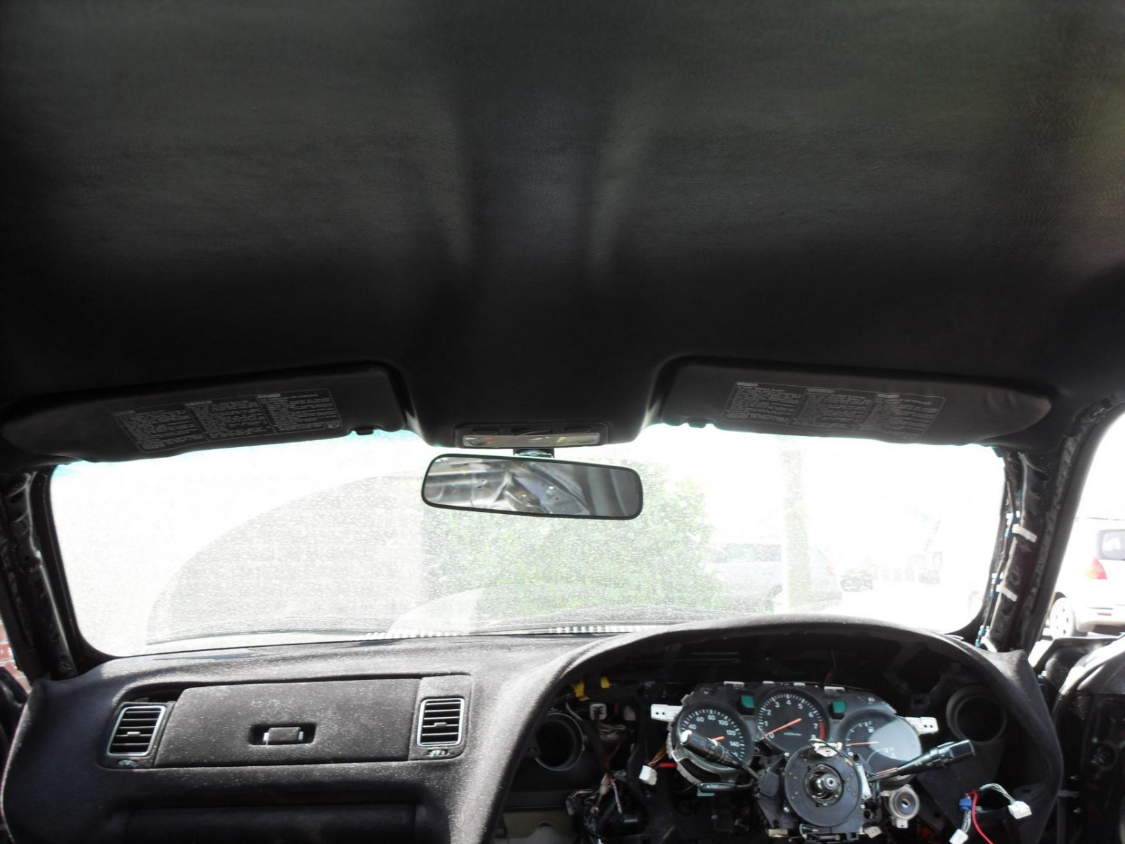

So here are my parts that have come back,im well happy with the result! ive yet to mention the guy i used! long story short i called and emailed 6 companys from all around the uk for quotes and in the end i went with this guy i found on ebay,see the link.........
http://cgi.ebay.co.uk/Flocked-Dash-Dashboard-Flocking-/130503499641?pt=UK_CarsParts_Vehicles_CarParts_SM&hash=item1e629d5f79
For all the parts you see in this pic was charged £275 ive asked him and he says mail service is available for £20 extra that inc delivery back to you....i didnt use this as hes only in york so i droped my parts in.
